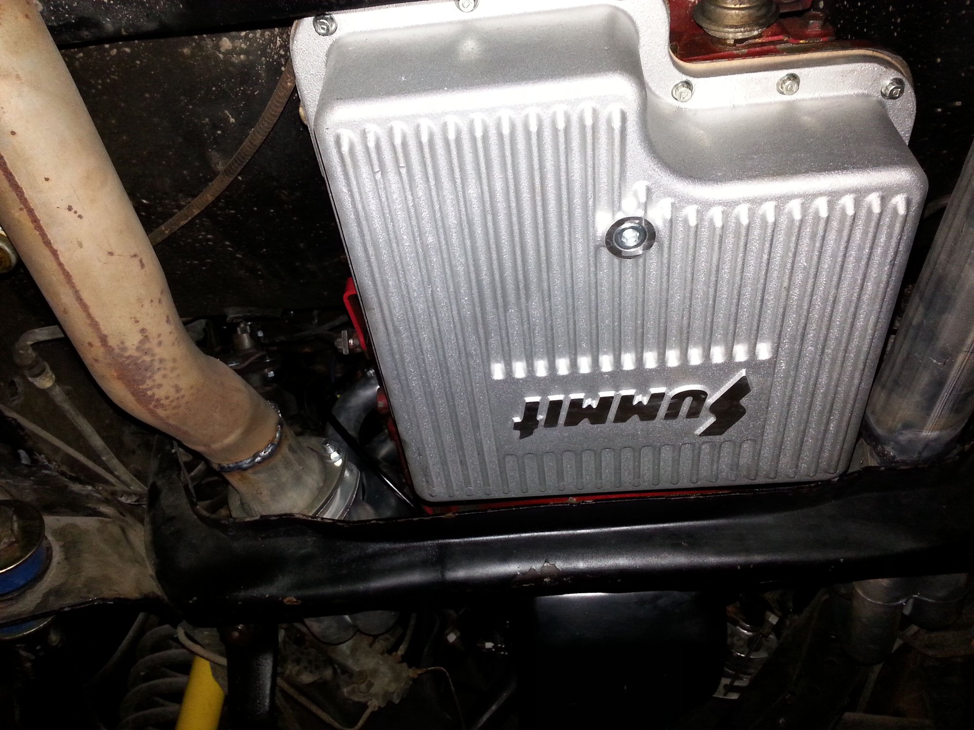

skeeter1971's Avatar
skeeter1971
Joined: Feb 2015
Posts: 194
From: Austin Texas
Here is the one from Summit I installed. Aluminum, finned, extra quart, fits no problem, good drain plug location, and just looks good. $150 dollars
