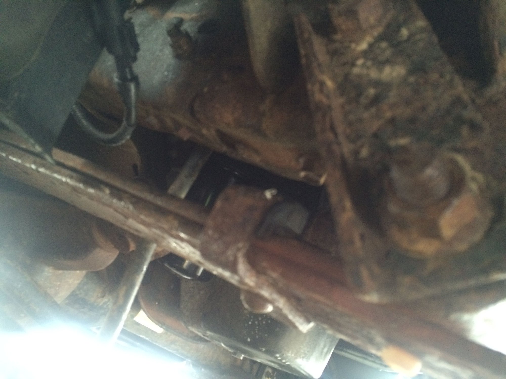

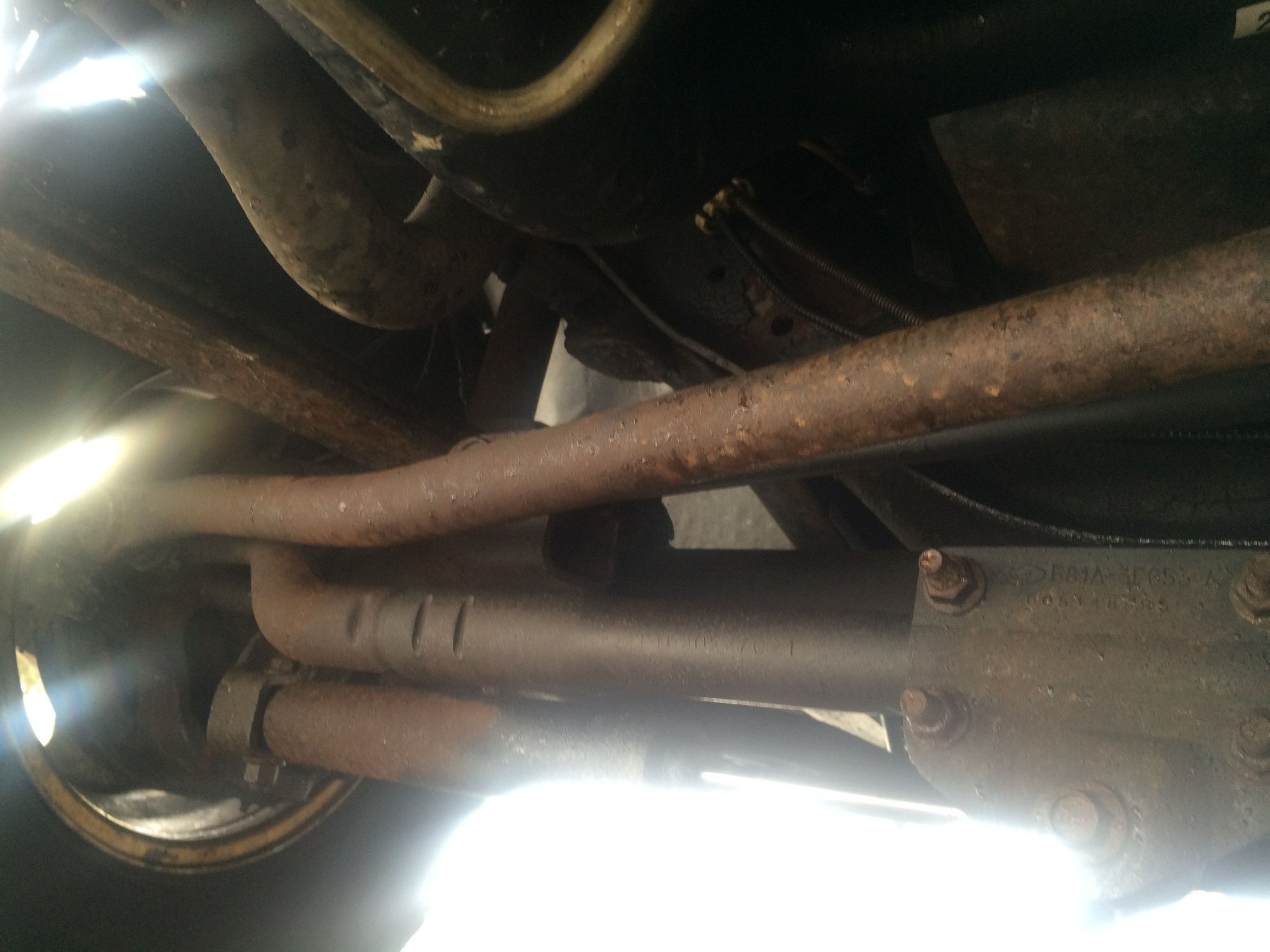

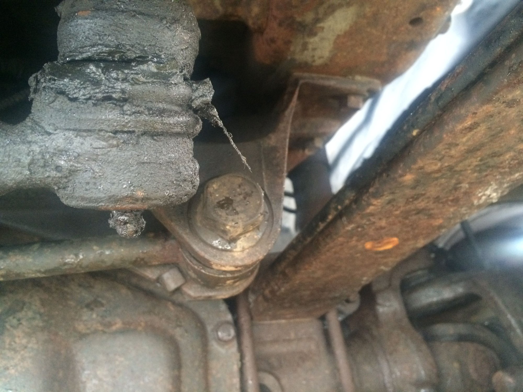

What am I measuring?
Took pic

The distance between the spring and the bump stop as well as noting the condition of the bump stop.
