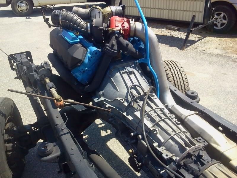

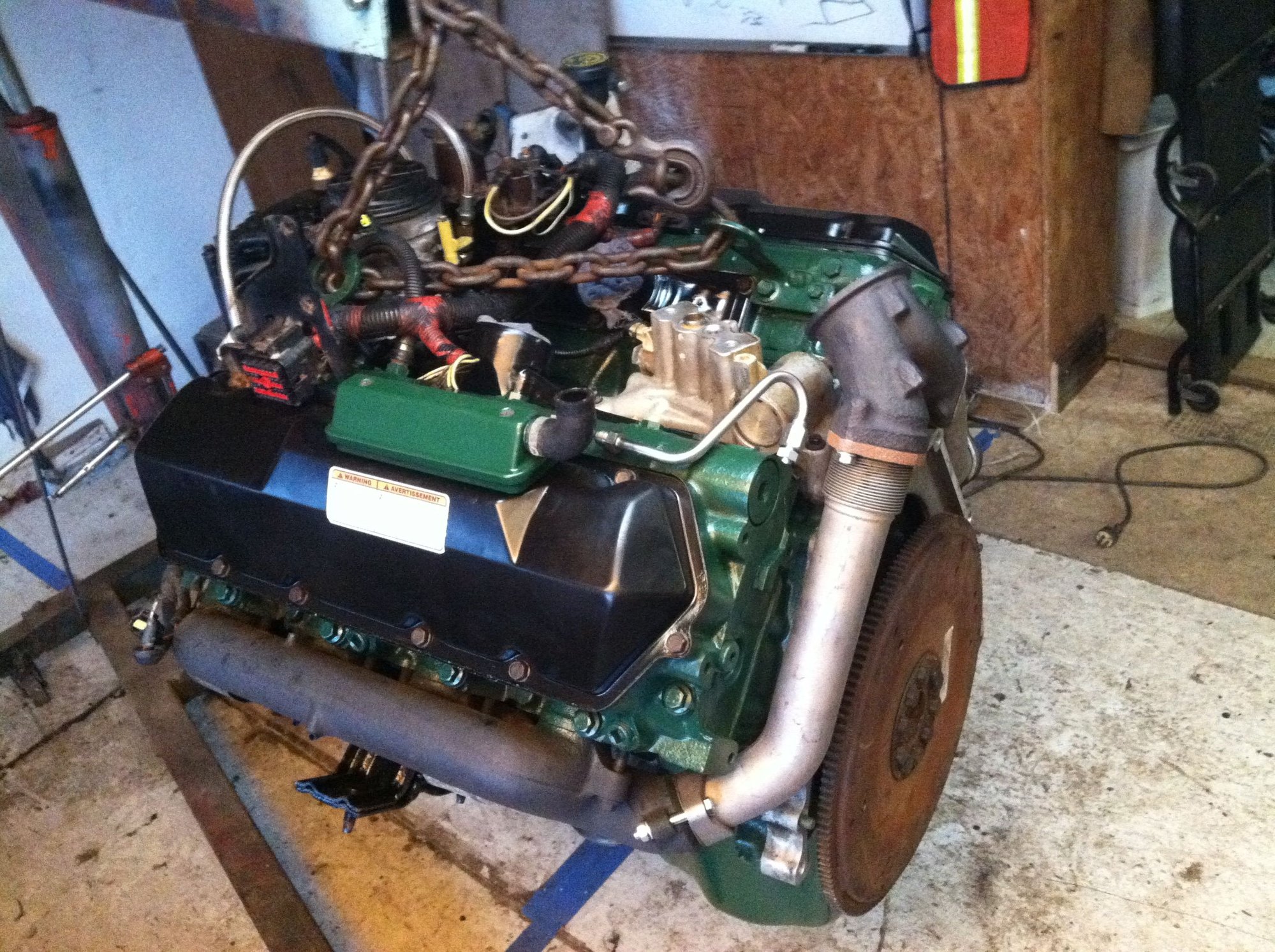

You won't be able to use ELC coolant, the E99 cups are not compatible. Remove the block drains before installing the engine and re-install them loosely. You'll want to do a full coolant flush on your 'new' engine and its MUCH easier to get those plugs out now.
If you have time and budget, I would consider rebuilding the fuel bowl, the turbo pedestal (or do EBPV delete),the turbo and the oil cooler 'while you're in there'.
If I think of something else, I'll post it later! Good luck!
Oh yeah, clean and paint that sucker.
All you need for the block, VC's, oil pan, etc is plain 'ole enamel. I like the rustoleum 2x products. I use VHT Flameproof (2000*) on exhaust manifolds, up-pipes and turbo exhaust housings.
