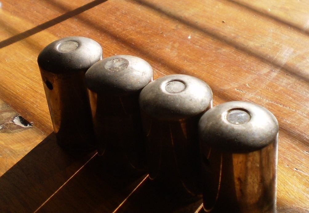

Here's why I am replacing all mine, the valve stem punched/wore a hole in the lifter. I am going all adjustable and also doing a complete overhaul since I have the motor out and on a stand.
This wasn't the only lifter, 3 others were worn to the point of replacement, i.e.; dimpled on the top .030-.050 of an inch!

I saw your lifter in another thread. That engine was severely abused; to punch thru I'd guess it had a stuck valve, and it was run anyway. No way it's wear from normal use. Here's some lifters from a similar situation. You can see the one that isn't punched is not worn significantly. The valves that were stuck/sticking had to be torched out of the block they were so rusty.
