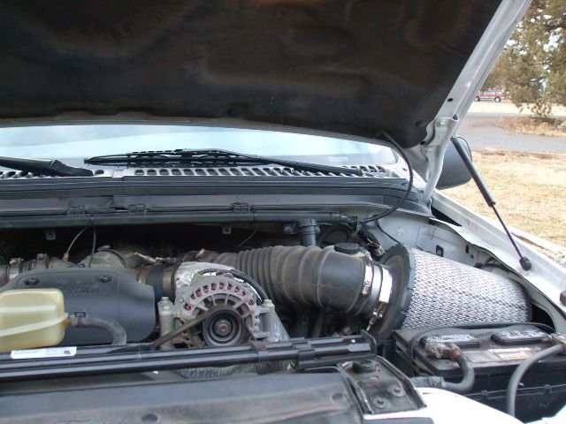

I would much rather have a tuner for $400. I used to get a Napa 6637 filter and a short piece of pipe from a hardware store. This worked great and cost about $60. I attached a pic of what I and many others have done.
