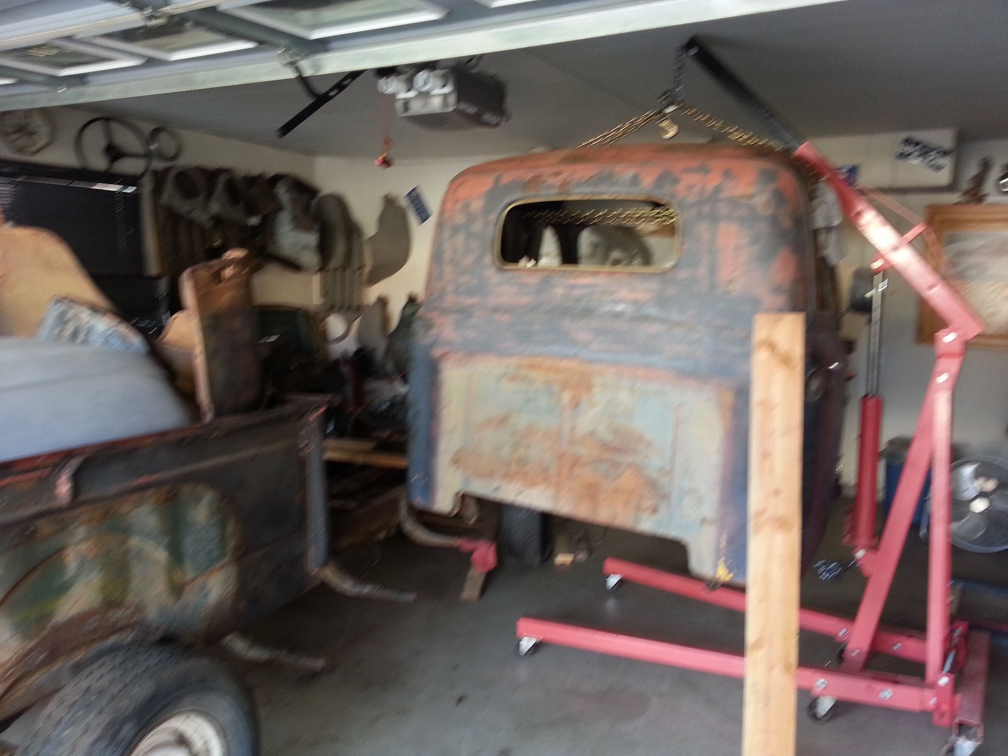

Fresh off the tow truck

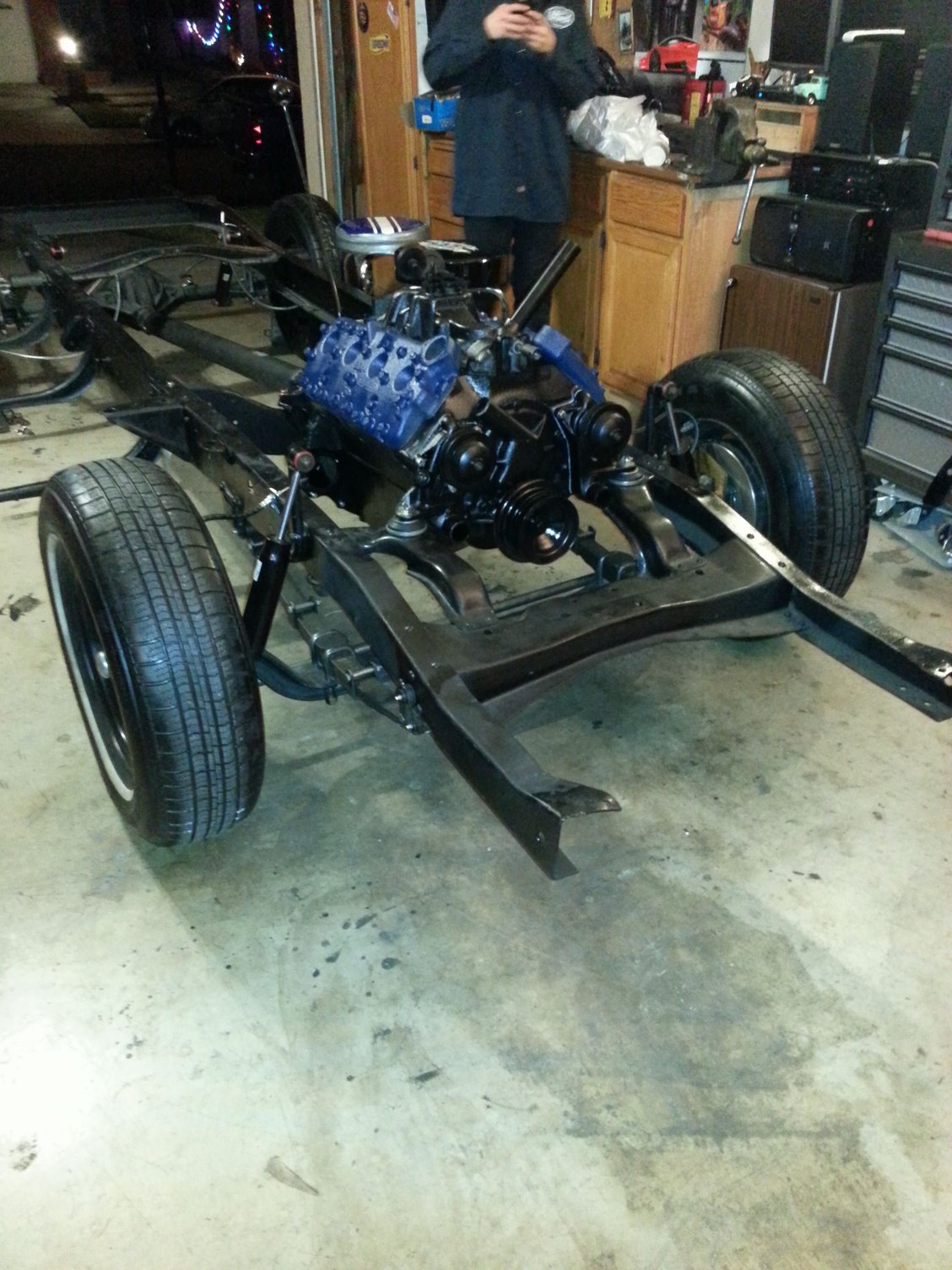

Dismantling - had to get creative since it was primarily a one man show
Frame in decent shape but had original trans-x member missing and a few areas that needed repair
Only modern upgrade - disc brakes - all new springs - lowered in the rear (3inch), shocks, swapped to dana 44,dropped axle (3inch?),
78-7006 3 Speed Tranny rebuilt by Al Zannino
Challenge with flywheel, it was Merc 6 hole pattern, got it redrilled to match the PP and 10 inch disc.
Stock Flathead rebuilt by Karl's machine shop at 1/2 price of local popular speed shops. Karl has been at same location 30 years and knows his stuff.
Nothing just bolts in, picked up rebuilt generator w/ wrong pulley size (fixed_,swapped to 6 blade fan thanks to Larry, rebuilt 94 Ford Carb...waiting on funds to finish engine :-) then on to cab, steering, etc.

Finally the generator, fan and belts are in after much struggle will belt sizes, broken intake bracket guides.
Also re-cored (4 cores) radiator, pipes and hoses installed.
Most of the body has been blasted and DTM primer applied.
Overall in decent shape other than typical rot spots.
Next step will be to figure the under cab coating before mounting on the frame.
