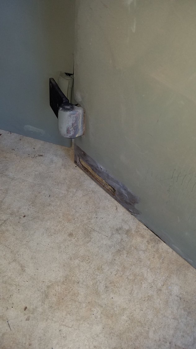

Little Progress but Progress
Cut out rott
welded 16gauge strip
body filler
rookie/poor man's body work :-)
