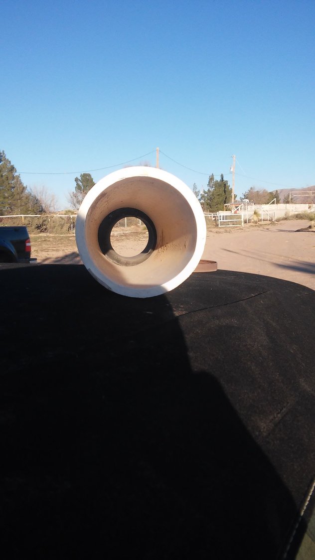

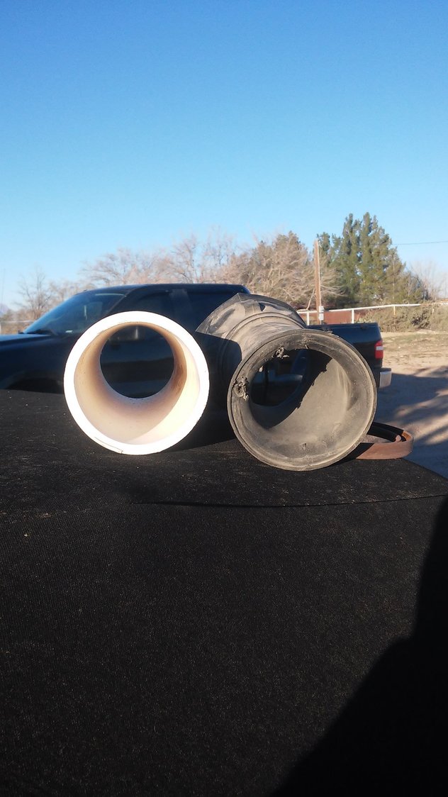

Heres a pic of a 3" pvc pipe comparing to the stock 6.8 and 5.4 intake snorkel
My wifes X has both mods, 5 star tunned by Mike, spd y pipe, straight piped (deleted resonator and muffler,) No proof that it helps but it feels like it took some of the slack from the bottom end when towing. The other thing I noticed that while towing my intake manifold feels cool to the touch when I did the Zoodad mod. No dyno, so how effective is it but it worked for me.
