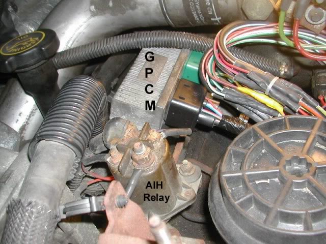

If it is a Cali truck you should have something that looks like this GPCM:Name:  GPCM20Underhood.jpg
If it is a 49S you'll have something that looks like this GPR courtesy of PaysonPSD:
Wiring diagram for both:

Could just be plugs not seated on the GPCM.

I didn't get a chance to look under the hood last night to see which type of GPCM I have but I plan on checking the connections later. A bad connection makes sense because I'm getting a open code for each plug(except for #6). Do you think they could all go bad at once? If they were bad I should always have issues firing, wouldn't i?
