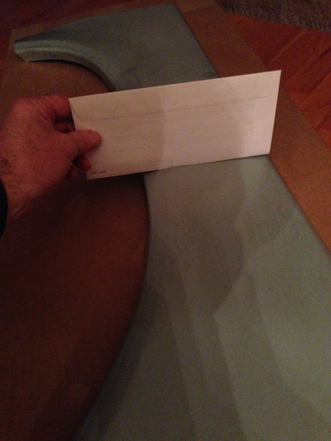

Okay - patch panel from Tabco arrived. Unfortunately, it doesn't have the flare either. here is a photo taken showing how it is flat from the wheel lip up to the dent (trim channel)
Bummer

Dang. Maybe just get the full panels

LMC catalog shows small patch not having flare, but large patch having the flare. I will call and ask them to send me a pic of the actual part, unless someone here has used them. After talking to Tabco, who were very confident their patch had flare, I am going to confirm before paying shipping again.
