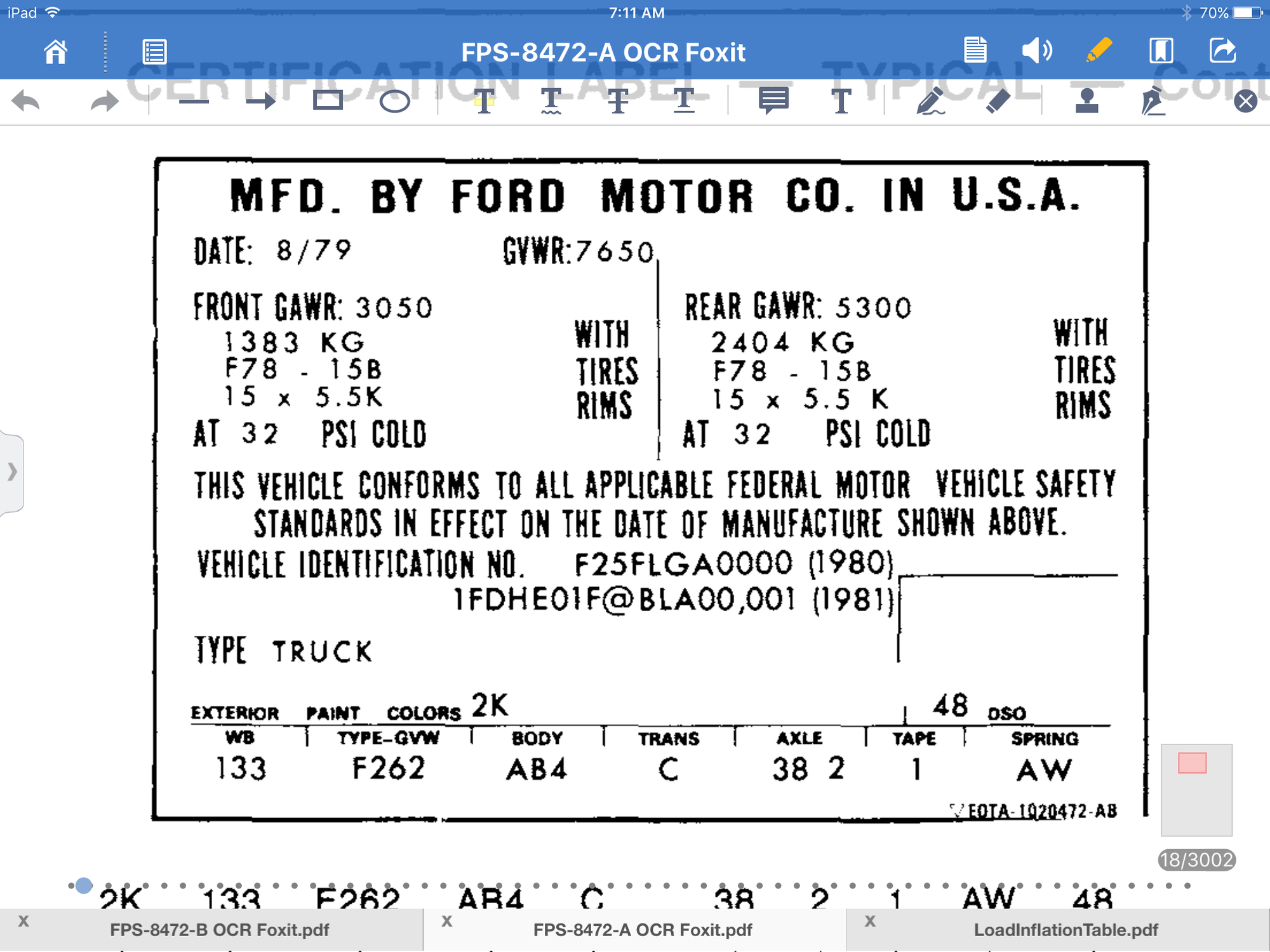

According to what I understand of what Bill said, the "3" of the "Axle Code" from the certification label has nothing to with the front or rear axle ratio. It means "power steering delete", and a "2" means "Front Axle Limited Slip".
And if I understand, in spite of what the catalog says below, you cannot get the front axle ratio nor capacity from the label. Instead, you have to have the tag off of the axle itself.

What we've gone through here, and other times as well, has convinced me that the next section of my web site needs to be an interactive decoder for the certification label. Each of the codes will be a link, like in the front clip section of fasteners, and the link will take you to the appropriate table.
I'll use this example label from the parts catalog:
