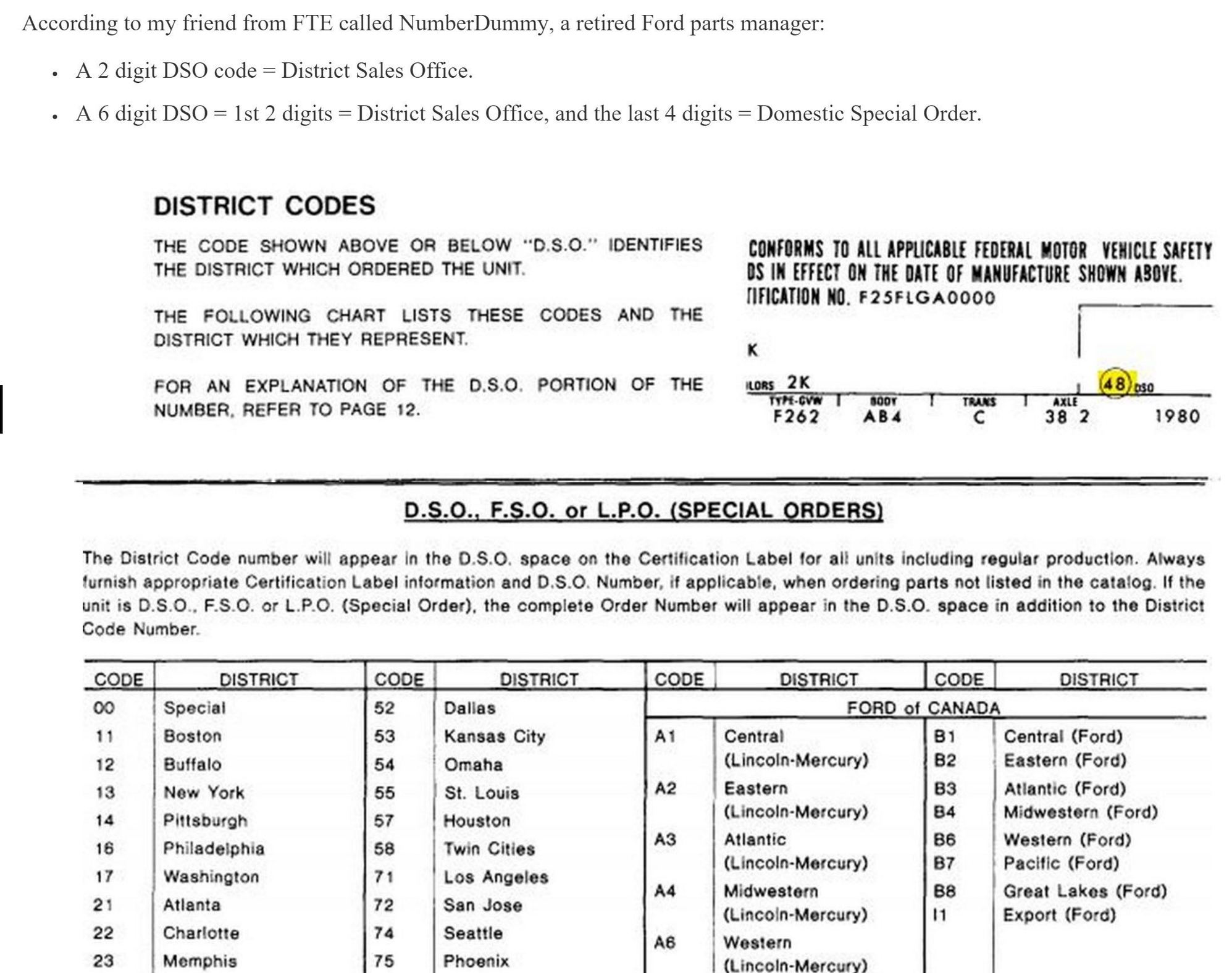

When I saw on the Certification Label that you said DSO translates to dealer special order .. I said what the hell?
2 digit DSO = District Sales Office.
6 digit DSO = 1st 2 digits (see above), last 4 digits = Domestic Special Order.
2 digit DSO codes:

Good catch! Thanks. But, it wasn't I that said "Dealer Special Order". That is directly from Page 18 of the catalog. Here it is w/o my blue boxes and correction to the example. But, I'll correct it on my web site.
And, I have the district offices listed on my site.
Old Jan 18, 2016 | 06:48 PM

My DSO page now reads as follows. Hope that's ok with you.
Old Jan 18, 2016 | 07:11 PM
  #45
NumberDummy's Avatar
NumberDummy
Ford Parts Specialist
Posts: 88,826
Likes: 785
From: Simi Valley, CA
Oh where oh where did my little dog gone? Oh where oh where could he be?
Look at the DSO list below (same pic in post 42), you omitted quite a few above.
