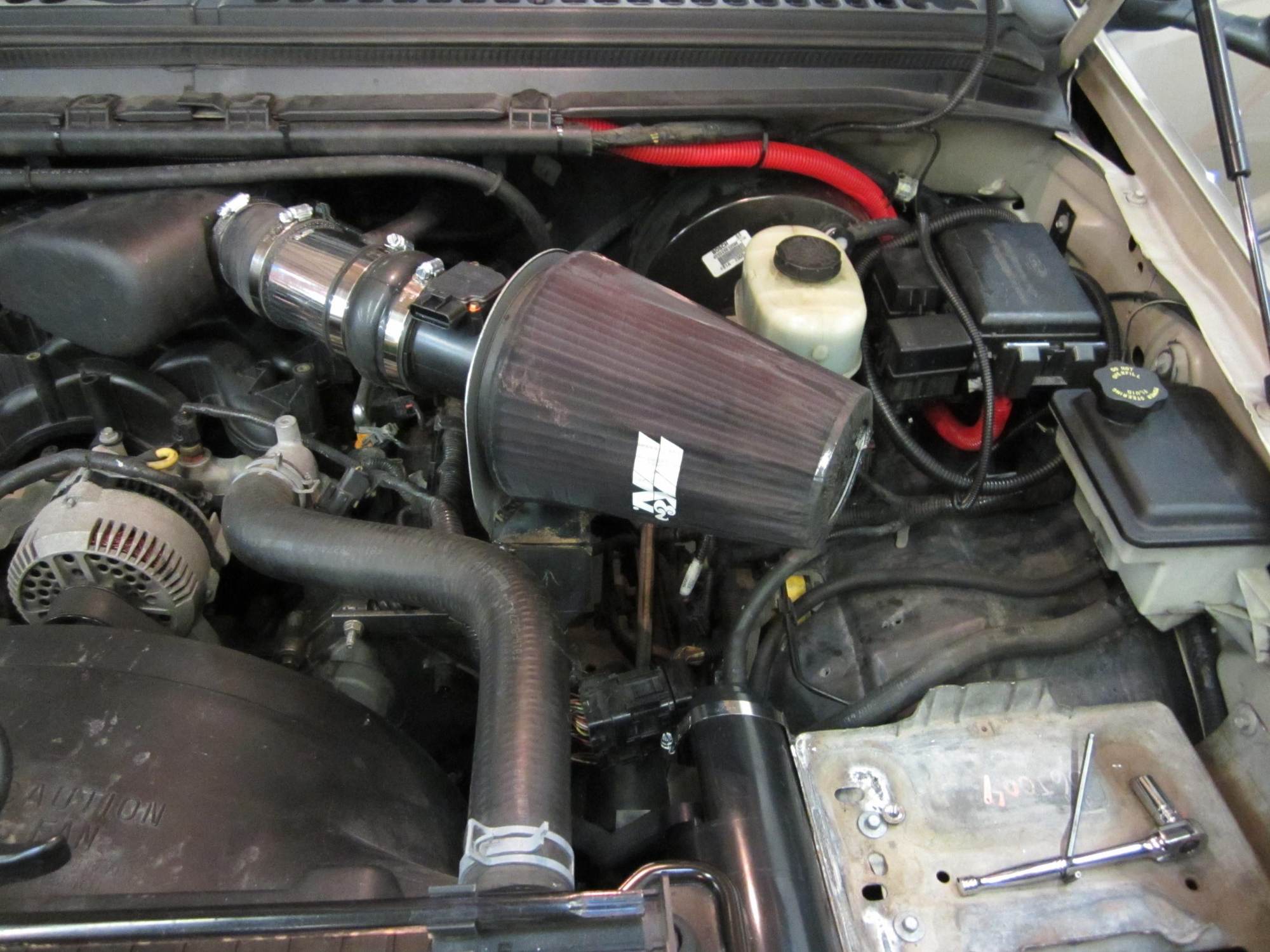

I kinda built my own setup for my 2000 F250 5.4L Sorry my only picture is during the mockup as everything was powder coated
