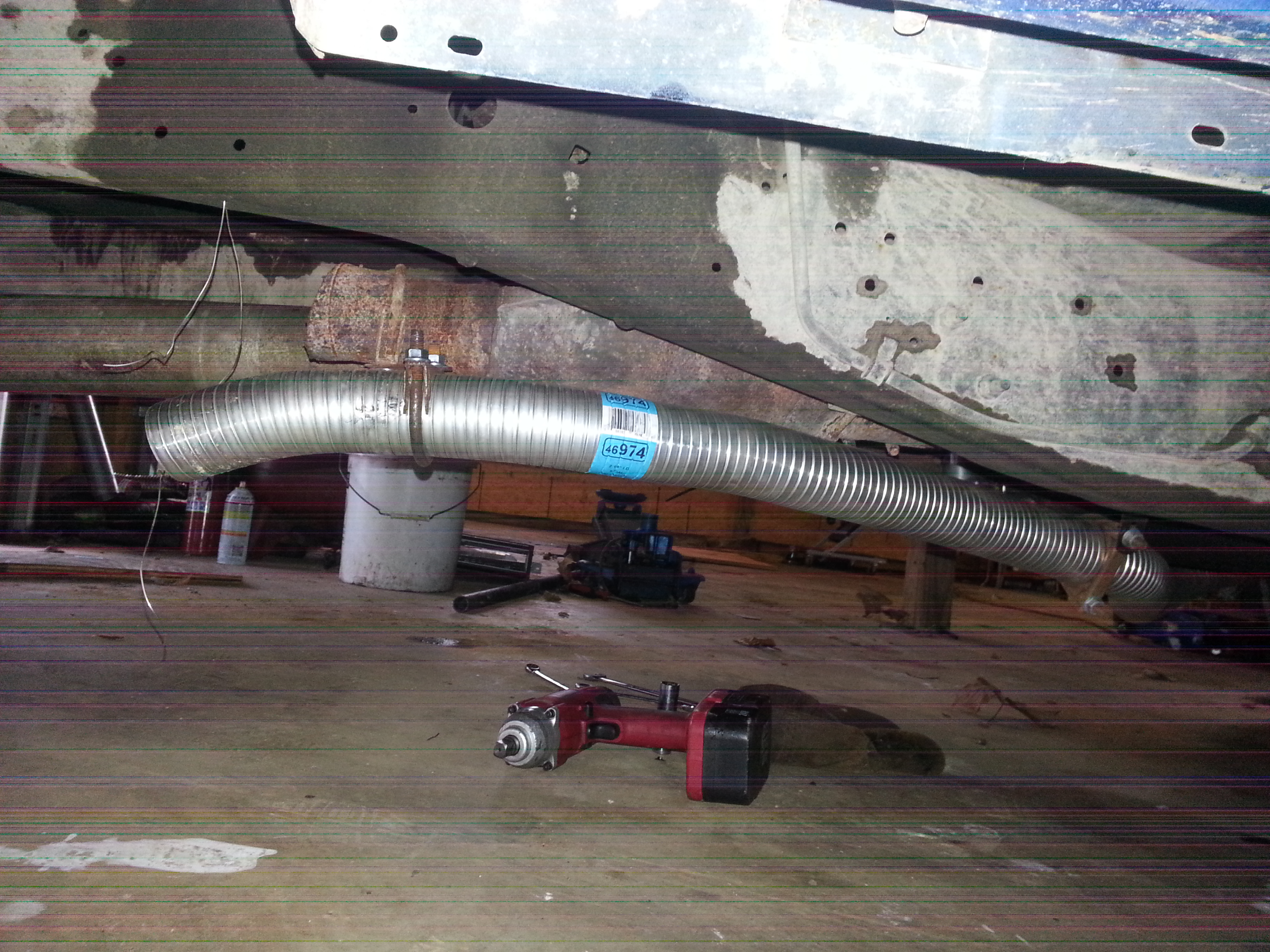

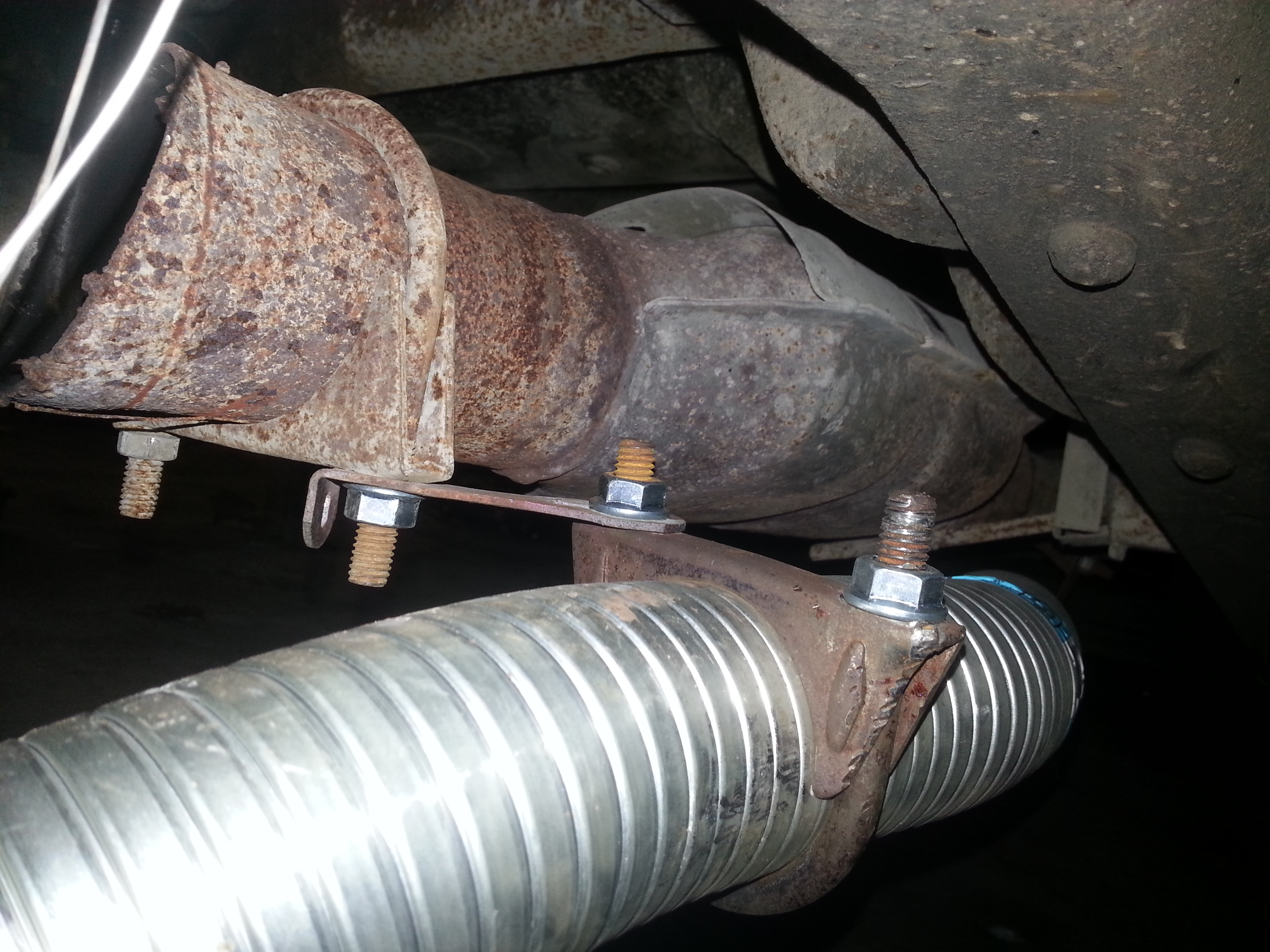

My current exhaust setup. One side was already there with hangers so I kept it and ran flex pipe on the other side and made some basic brackets out of exhaust clamps and pieces of metal.

On a personal level I really agree. But for costs sake that is all I could afford at the moment was to reuse some of the old exhaust and do the flex pipe. The main reason for the flex pipe was because the old exhaust could not clear the cross-member and the bolts to the collector on that side will not budge for me.
Money is tight for me but when spring comes and I get full time hours again at work I am going to have a shop do it all from header back the way I want it. I want two 12 inch glass-packs as mufflers An H pipe for better flow and two tail pipes that exit out the rear behind the axle as side pipes. But for now straight piped and dumping under the bed works.
