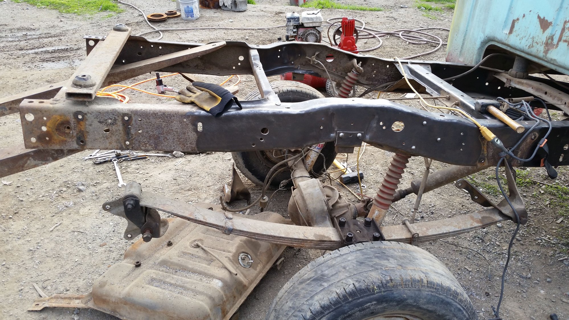

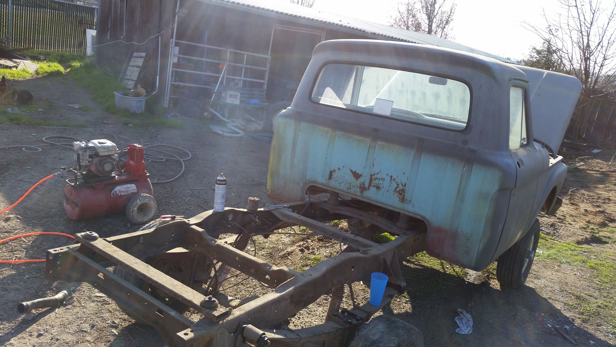

I have a 94 donor with clean gas tanks. Google has not helped me out here. I am hoping I can get sending units that will fit these WITHOUT fuel pumps??? I attempting to put these tanks into an old project truck. I want to run the rear and auxillary in a 78 bronco frame. I am planning a manual fuel line selector and a switch to my gauge to show the appropriate tank. Will these newer sending units work properly with a 65'cluster (voltage wise)? I am more a fab guy than an electrician. Hopefully someone can set me straight or shut me down or point me the right direction before I get ahead of myself.
Removing the 35 years of nastiness. Working my way through the frame. Taking out crossmembers. Haven't decided on grade 8s or welding back in. Ditching the billy bob blocks for some lift springs that should work with the existing shocks. Just cleaning, upgrading, painting. I hate corrosion.
I really hate corrosion
Wire wheel (lightly- not to undo heat treating), strip, clean, etch, etching primer, topcoat. Did i mention i hate corrosion? This is my ocd therapy here.

Originally Posted by bb65f1004x4
....Working my way through the frame. Taking out crossmembers. Haven't decided on grade 8s or welding back in....
Most of the people who seem to know the most about it bolt crossmembers back in rather than weld. And that's even people who do a LOT of TIG welding and fabricating, so it's not because welding isn't available to them. Makes me think I'll go with grade 8 bolts any time I'm doing it.

These frames flex.
Welding the crossmembers in is just going to create hard points where it will crack or tear.
