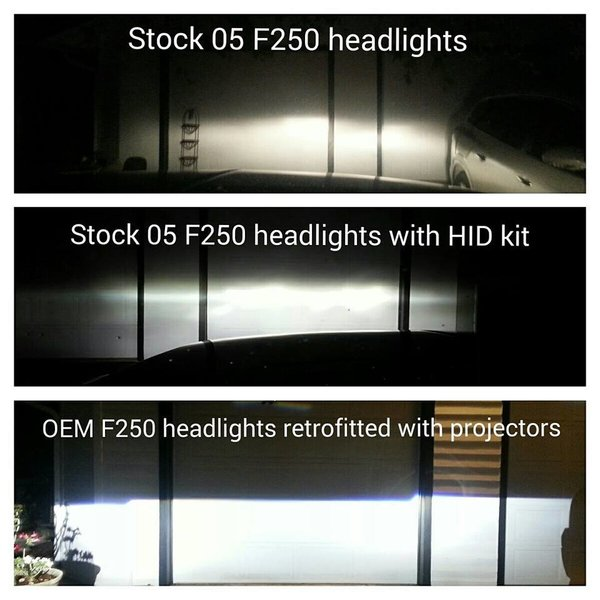

This is the photo I was thinking of..... Its from All Out Industries. He is Whiteout FX4 on this website. Here is his build thread. https://www.ford-trucks.com/forums/1...iat-build.html
Any way, here is the comparison and the product link:
05-07 F250/F350 Prebuilt w/Mini H1 Projectors | All Out Industries
