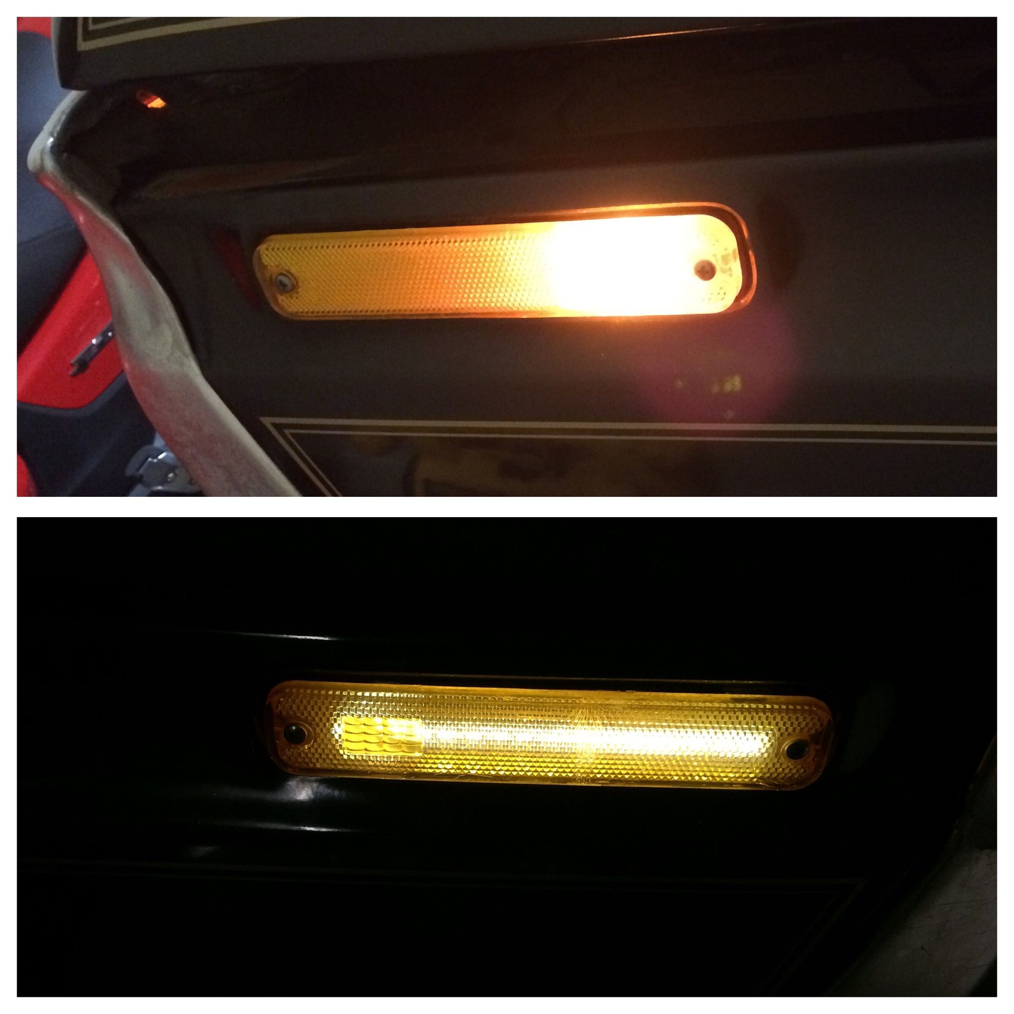

Originally Posted by 78 PEB
Did you use LED bulbs for the side markers? How about the fronts? TIA
I used strip LEDs to replace the single incandescent bulb in the side markers:
I got the idea from the 'Tips and Tricks' thread posted by HIO Silver!

thanks for the pics n more links. really like the led strip in the side markers. fills it up much better
