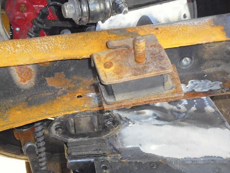

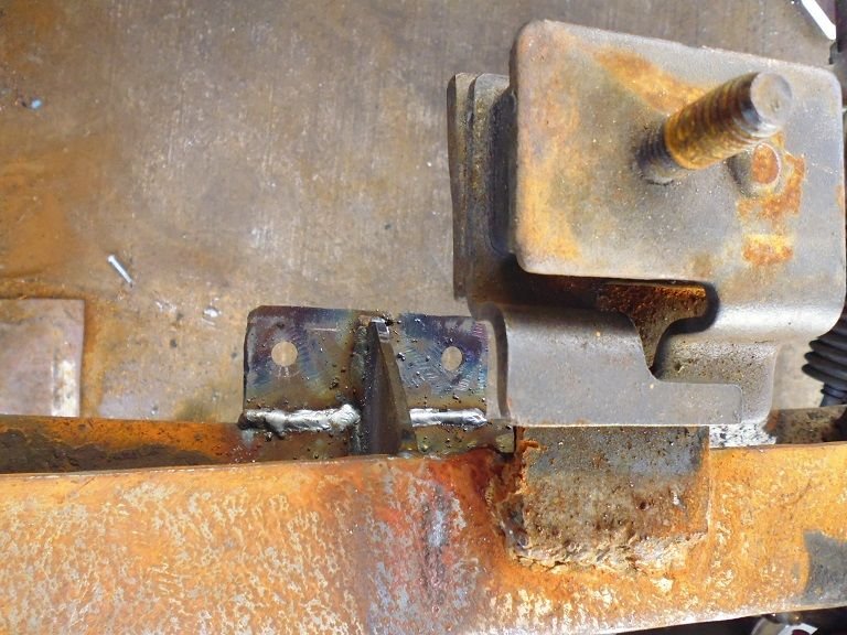

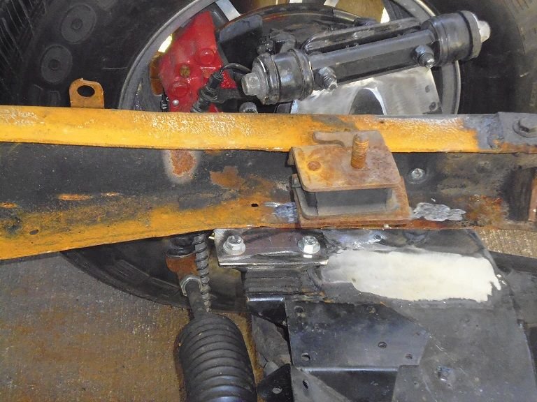

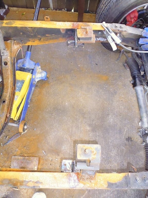

Hi Robert. Hope this gives you some idea of what we did. We just fabbed up some plate just below the engine mount setup on my '54 (it has a Chev engine hence the GM mounts)
Thanks gives be a better idea of how I need to mount the rear of the ifs

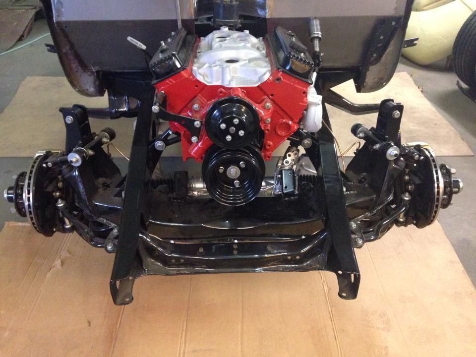

this is on a Chevy frame

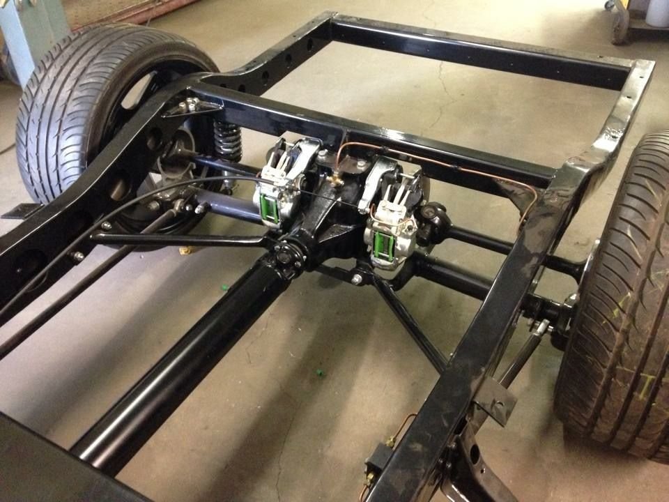

Do you have anymore pics and how did you hook up the brake lines.
Old Jan 4, 2016 | 04:21 AM
Björn's Avatar
Björn
Joined: May 2010
Posts: 688
From: Netherlands
A friend of my is building a half ton 53 chevy with rear and front jag that he allready finisht if you have facebook i will give you his link with all the pictures
