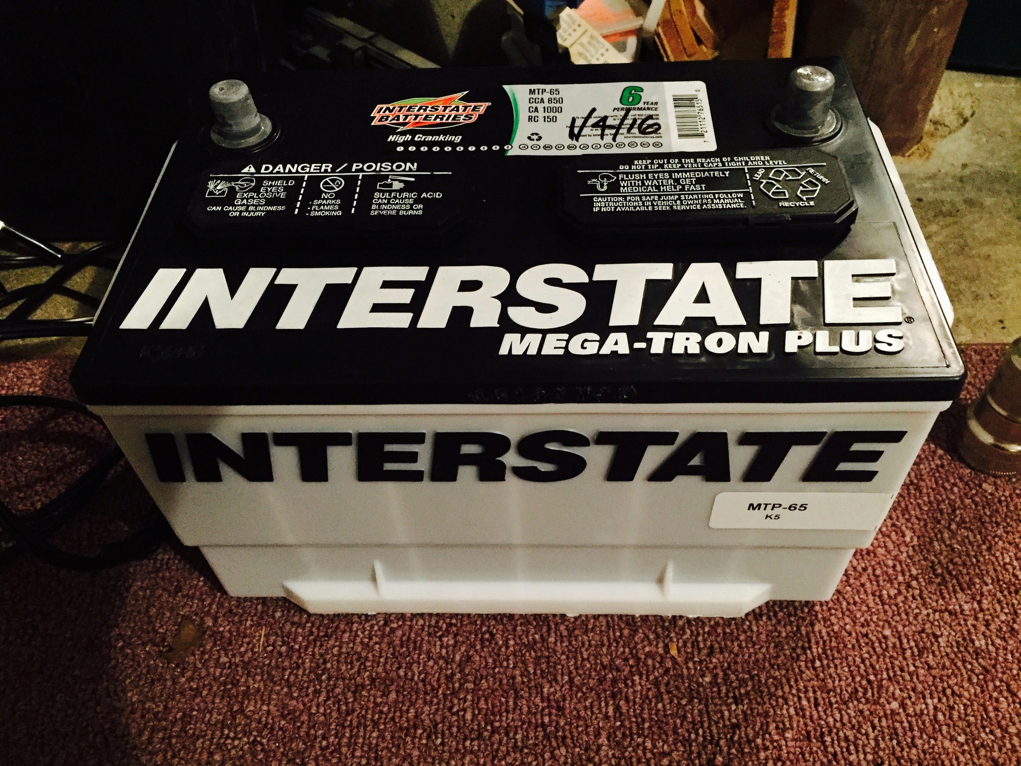

Great thread. A lot of good information. Wound up with a Mega tron.
