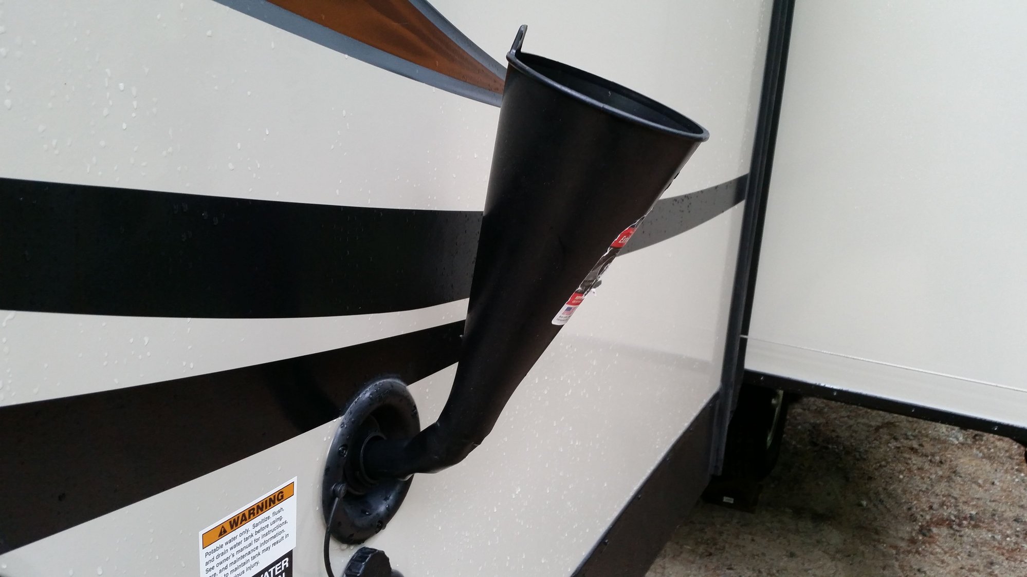

Installed a voltmeter in the entertainment cabinet. Mounted it in the side facing the door, so if I'm outside, a glance through the screen door tells me how my batteries are doing. Also good to see what the solar panels are up to.
A cheap and simple mod..... bought a plastic funnel, warmed it up with a plumbers torch and made a bend in it. Makes it easy to add water out of a jug when dry camping.
