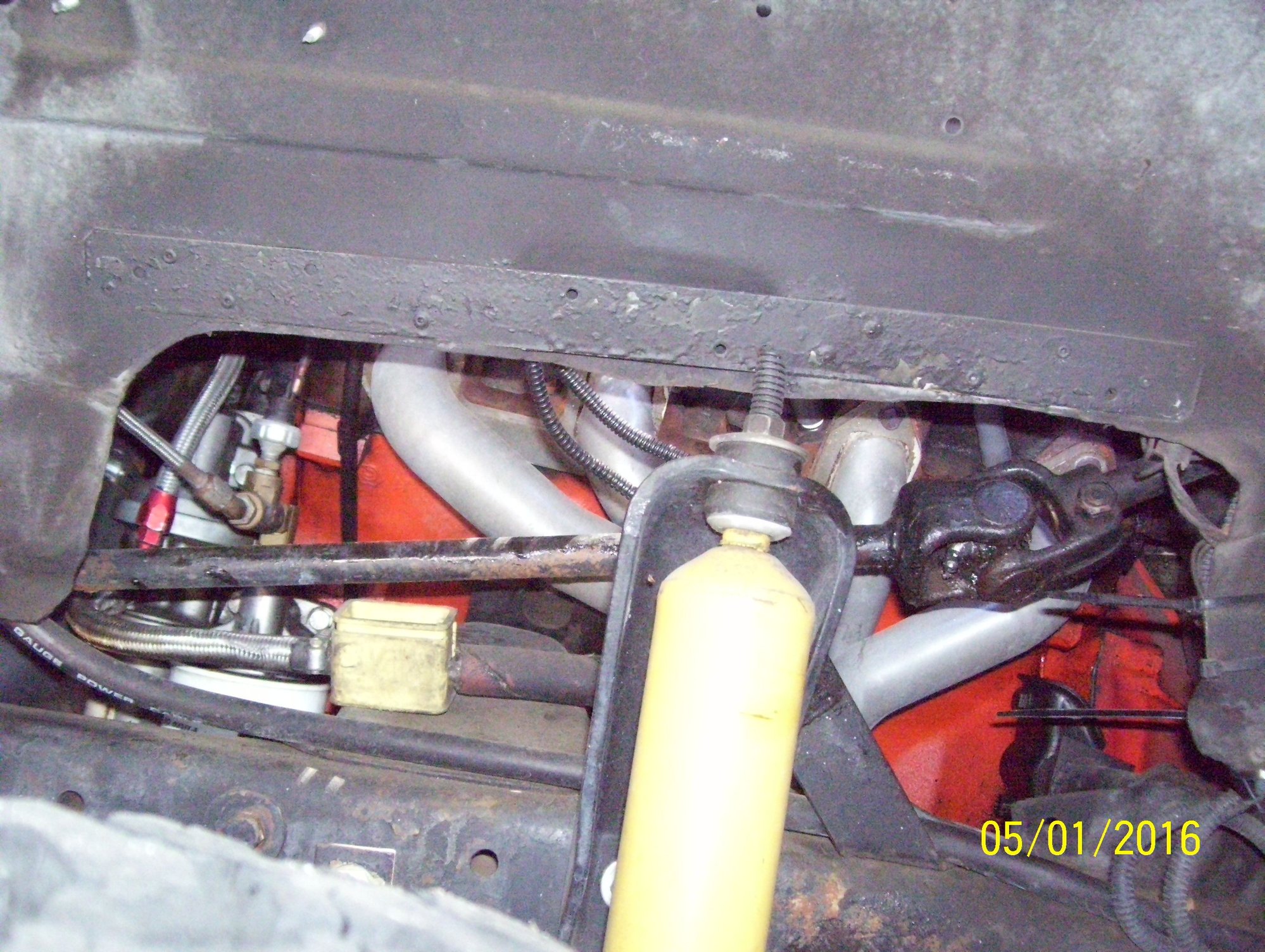

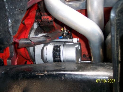

My coated headers have reduced heat a great deal.
But the Sanderson headers trap the starter in place with in 1/8" and after month then summer came my oem starter seem to now be dragging. This was when, I switched over to a mini starter
with now after about 7 yrs+- is still not having any starter issues.
I do understand yours is under hood heat with your I-6.
This was what, I did to help with under hood header cooling.
Plus doing this cut away made it much easier working on starter or headers.
Orich

Thanks very much Rich, that was informative, and to the point for both considerations. I purchased the Clifford Performance headers, mostly because they deal with 6's all the time, their flange was 3/8" think, and their mandrel bent tubing was 16 ga. and not the 18 ga which most others are. They are split, or two part headers, and have served me well for 3 years now, but like yours, I have had some starter dragging. Like you suggested, I am looking into the titanium wrapping for head deflection reasons. I have done the same inner fender relieving as you have, to allow the engine compartment to 'vent' the area.

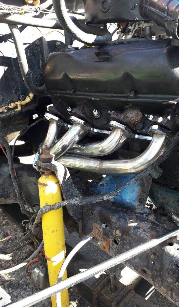

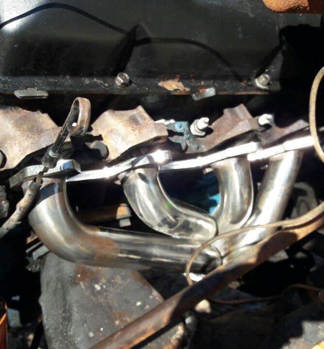

So far so good I guess. I'm a little concerned with the passenger side and room in the existing notch in the frame it will be close. I may need to cut a wider notch. I had one bolt break off so I was thinking of drilling it out and putting a nut on the back of a bolt through the hole. The P.O. tried to ram a larger bolt into the whole and that bigger would not come out. All the others were fine. Here are some pics.

Those look like car headers with it being overly close into the frame. You should not be needing to cut the frame like that. As you can see mine in post #35

you may think about insulating that black hose or cable that is on the pass. side picture. I concur with orich about the fitment. Maybe the pipe should go more back (over the top of that crossmember) then down? A ball & socket type collecter should fix that.

Thanks guys. There was a notch in the frame from the stock exhaust manifold setup. I think Ill be able to fit a pipe through there or perhaps a flex piece off the collector as Gary mentioned. I'm pretty sure this motor came out of a car and was dropped in this truck and they just made it work. These were purchased as an experiment and I think I can make them work one way or another. No turning back now!! Actually... Worse case Ill have to buy long tube headers for the highboy which should fit well. Ill keep ya posted.

Okay guys. I can finally tell you they fit. I did have to notch out the frame a bit more. This truck has never been so quiet! Overall I think the quality of these things are pretty good. The guys at the muffler shop that put the collectors on and tied everything in to the existing mufflers asked if they were L&L Headers. I hadnt heard of those but will look them up. The passenger side is probably touching the starter. Ill let you know how that plays out. I may have to install a mini starter someday if I have issues.
