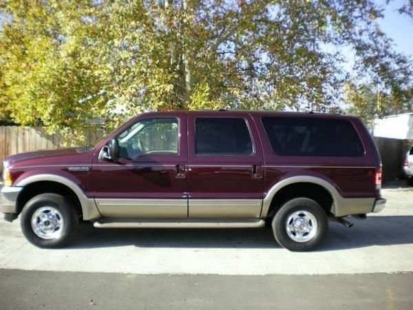

Correct me if I'm wrong fellaz, but isn't the V/B the "minimum" swap you can do using factory springs?
I know I went with V/Modded B since I tow, and I added air bags to 'fine tune' the rear ride height when loaded...I'm on OEM wheels/tire size.
Might be hard to see, but here are my before and after pics:
Before
After
Sorry, don't recall my measurements - I think they are on my V/Modded B swap thread.
