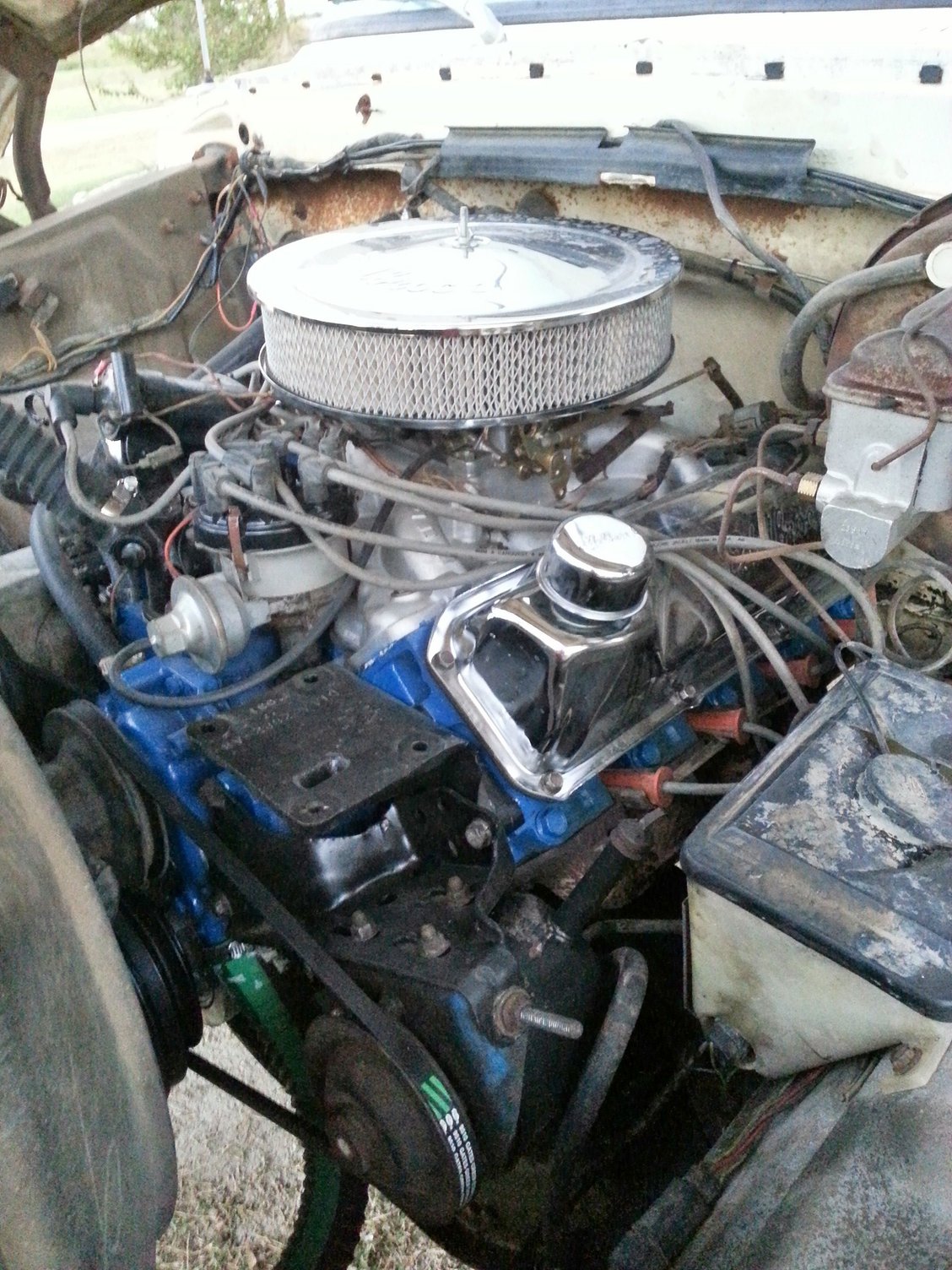

Test.. Pick of my other truck at the dump

Looks like I won't have a problem with the pictures. Have a great night all
