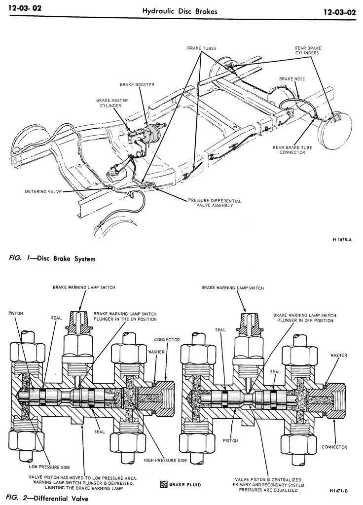

All wheel drum brakes won't have a proportioning valve. Your factory valve should be a pressure differential valve like the one pictured below.
Diagram of the internal workings of the pressure differential valve. --The Metering Valve shown in the diagram only applies to '68-'72 F250/F350 trucks with optional factory front discs. '67-'72 F100s weren't available with factory front disc brakes. The metering valve would be omitted from the system with all-wheel drums.
