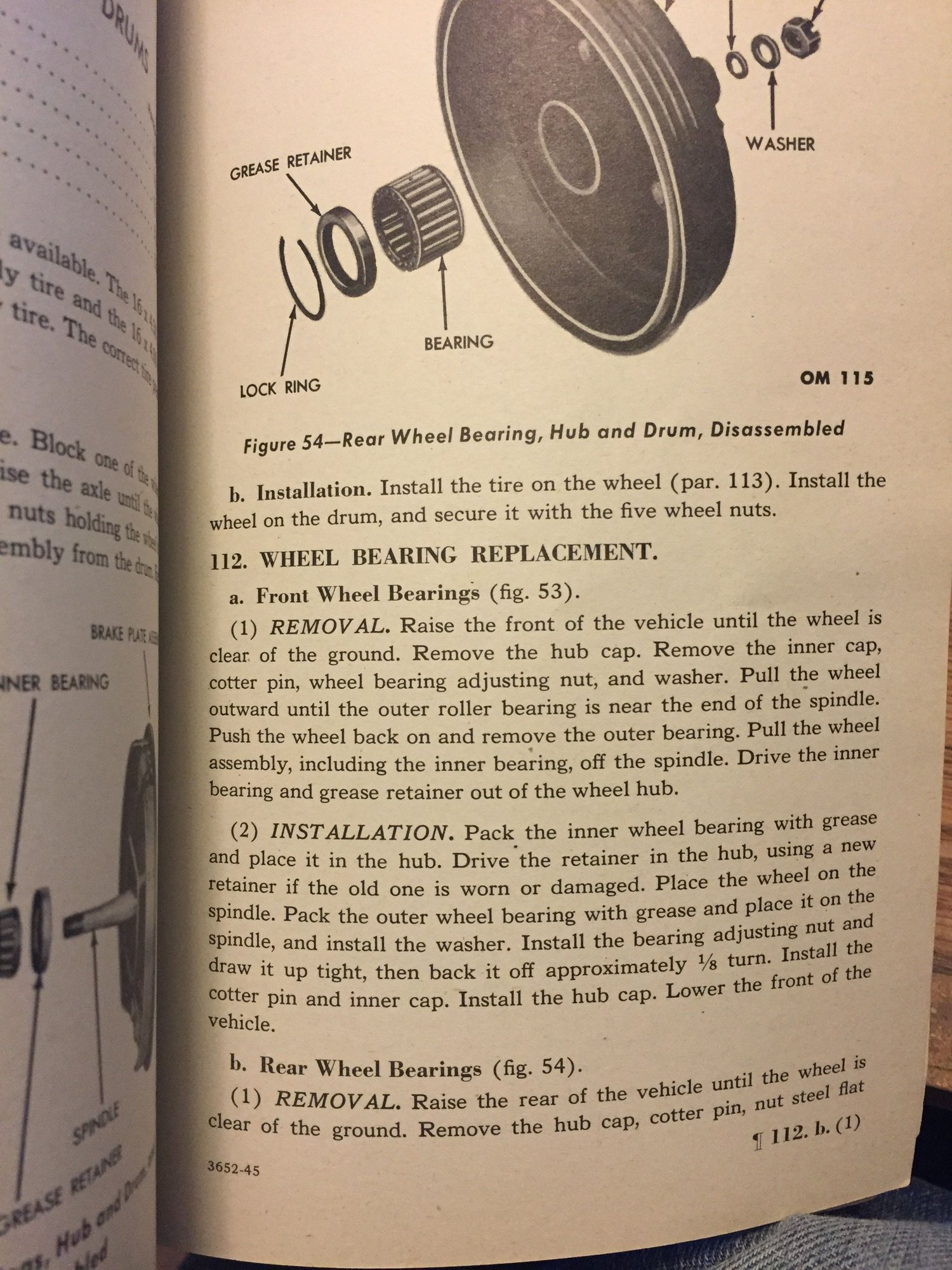

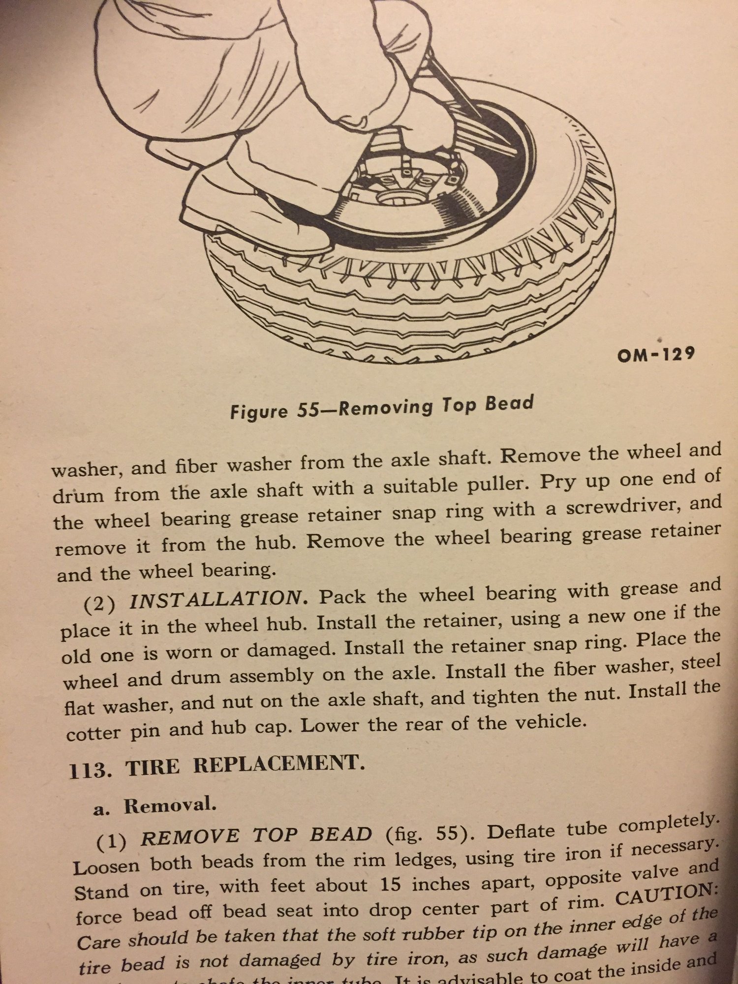

I got the hub off, being a farmer I have quite an assortment of pullers, what I was bashing was the studs themselves, as you are probably thinking I still have that farmers mentality, but I did use a light hammer and not a sledge I have not encountered the swedging of the studs before. As a matter of fact this is the first encounter with a banjo rear end. I ran into the keyed years ago on the old Dodge cars and trucks. With that being do you pack grease into the rear wheel bearings in the hub before you put them back on?

Here are a couple of shots from the manual that you ordered:
I have no experience with removing the studs from the brake drums but I would think that they could be pressed out.
