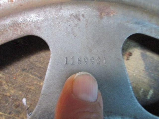

^^^^Good call gentlemen - 164 tooth all around for an auto, 300 straight 6 up to F350. (went down and counted the teeth on a '79 400 auto). The only numbers I could find on it are: 1169931. I know that don't mean squat, but there it is.

Posts: 2,698
From: Taxachusetts
Well, here be the numbers.... over all diameter - teeth to teeth is 14.25". As far as starters being interchangeable....(auto to manual) didn't work for me -- maybe I got some computer goober behind the counter who couldn't understand Engrish. Tried 3 times before I got the right one. Lousy azz parts stores or maybe I was off my meds that day. Ha ha.
