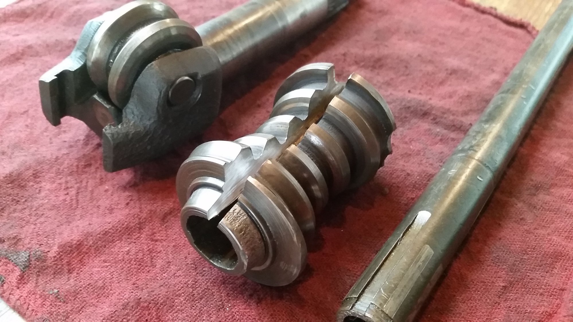

Great advice, but I think I have pushed to far.
I checked the clearance between the steering wheel shaft worm gear and the steering sector gear. Visually looks like they are to far worn.
I got the steering shaft out of the box by gently hitting on the threaded end, via a wood block and hammer. She popped right out along with the bearings.
Had to resort to the grinder for the worm gear removal. Cut a slot lengthwise to the steering shaft then used a hammer to remove.
I will need to press the new worm gear back on. Also will have to press out the steering sector shaft to get the new roller in.
I'll keep you posted, wish me luck!
Worm gear removed!

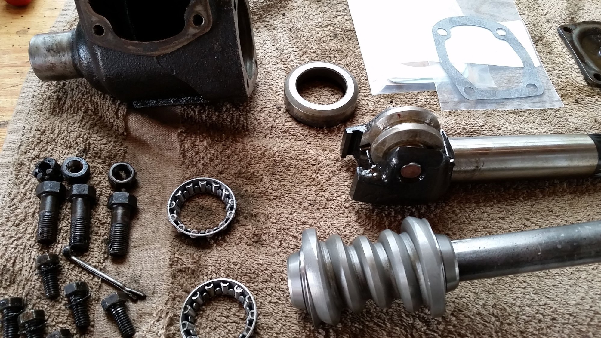

Had a chance to open some parts that were ordered on line. Most of these were a shot in the dark. Most parts look right on-line but just smaller in real life
The clue here is a part number with 81T..... is for the bigger trucks. I realized many of the parts that show fitting older 30's truck work perfect on the 46'
Interesting, my NOS steering sector that just arrived was wrapped in original sealed cosmoline. Fits perfect. Pretty cool!

Got the new worm gear installed on the old shaft. Heated it to 200 degrees then sledge hammered it into place.
Installed steering sector, bearings and other gaskets.
Put it back together and installed in the truck.
All of the play is gone, well worth the effort.
