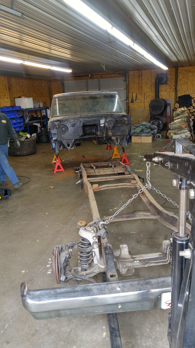

Day 1 spent stripping it down.
I've decided to do the CV swap with a 5.0 power plant. This truck originally had the 460. Rear end has been fully finished ford 9" disc brakes, posi 3.73 gears.

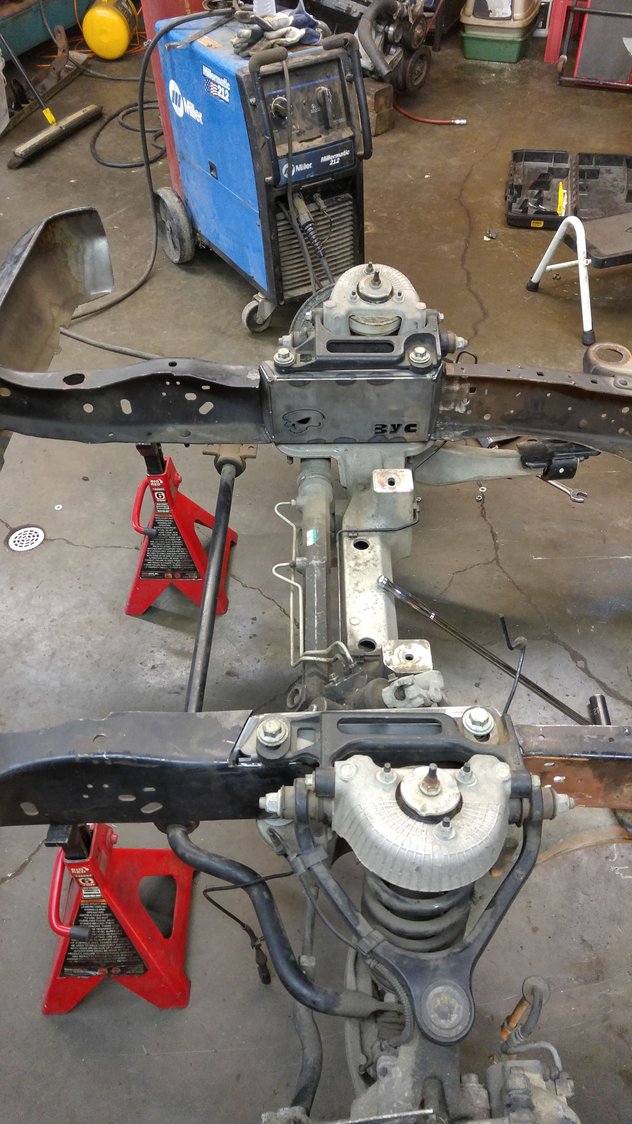

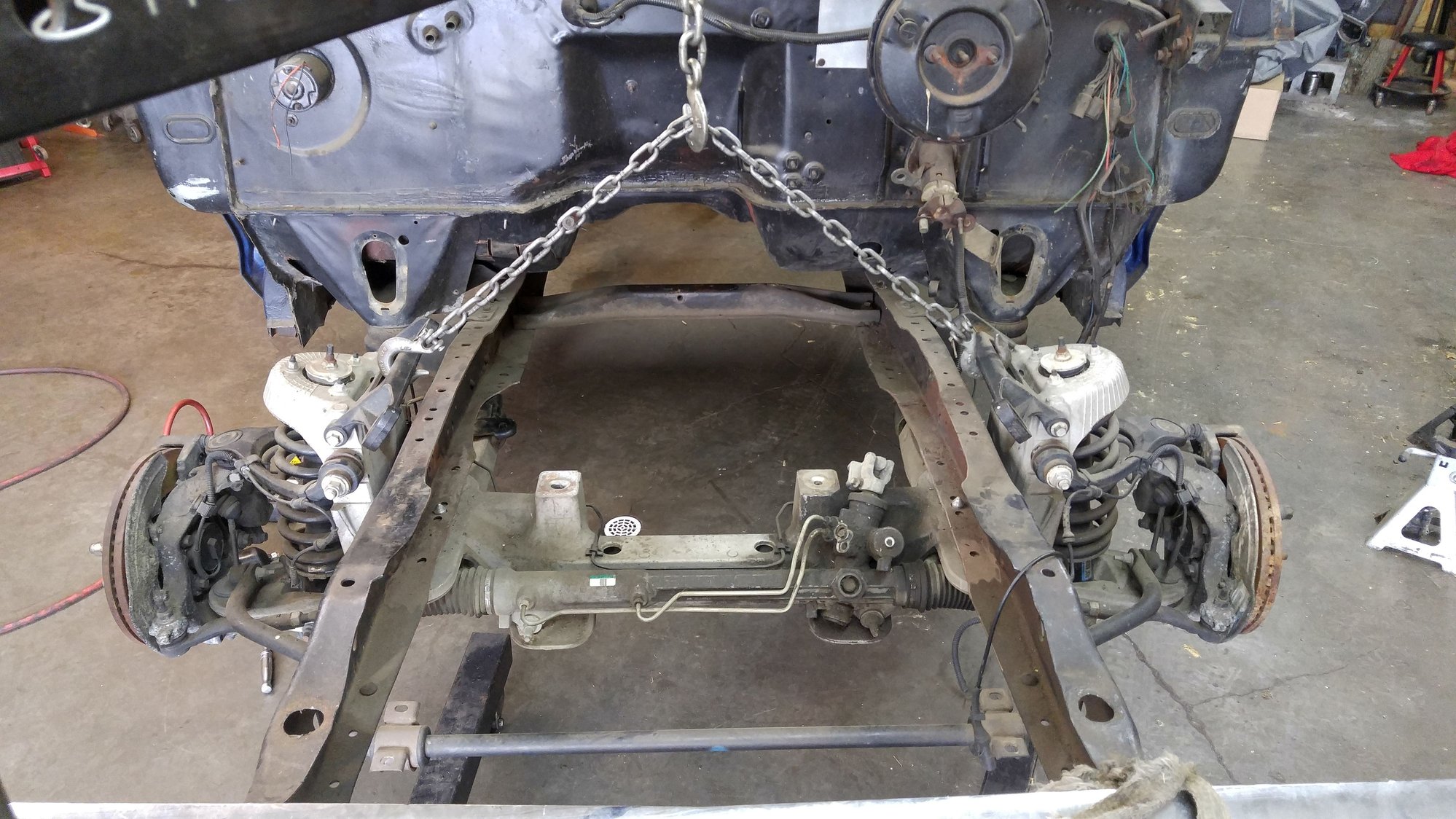

Got the Cv set into place to mark my holes.

CV ifs mounting boxes
Got all the holes drilled and boxes burnt it. I will say to anyone if you wanna spend the money these boxes are the way to go! 3/16th steel with .250 Dom tubing inserts on the insides. Makes for a very clean install
Everything bolted up.

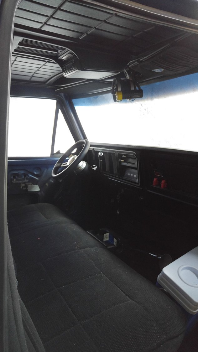

Interior is already complete.
