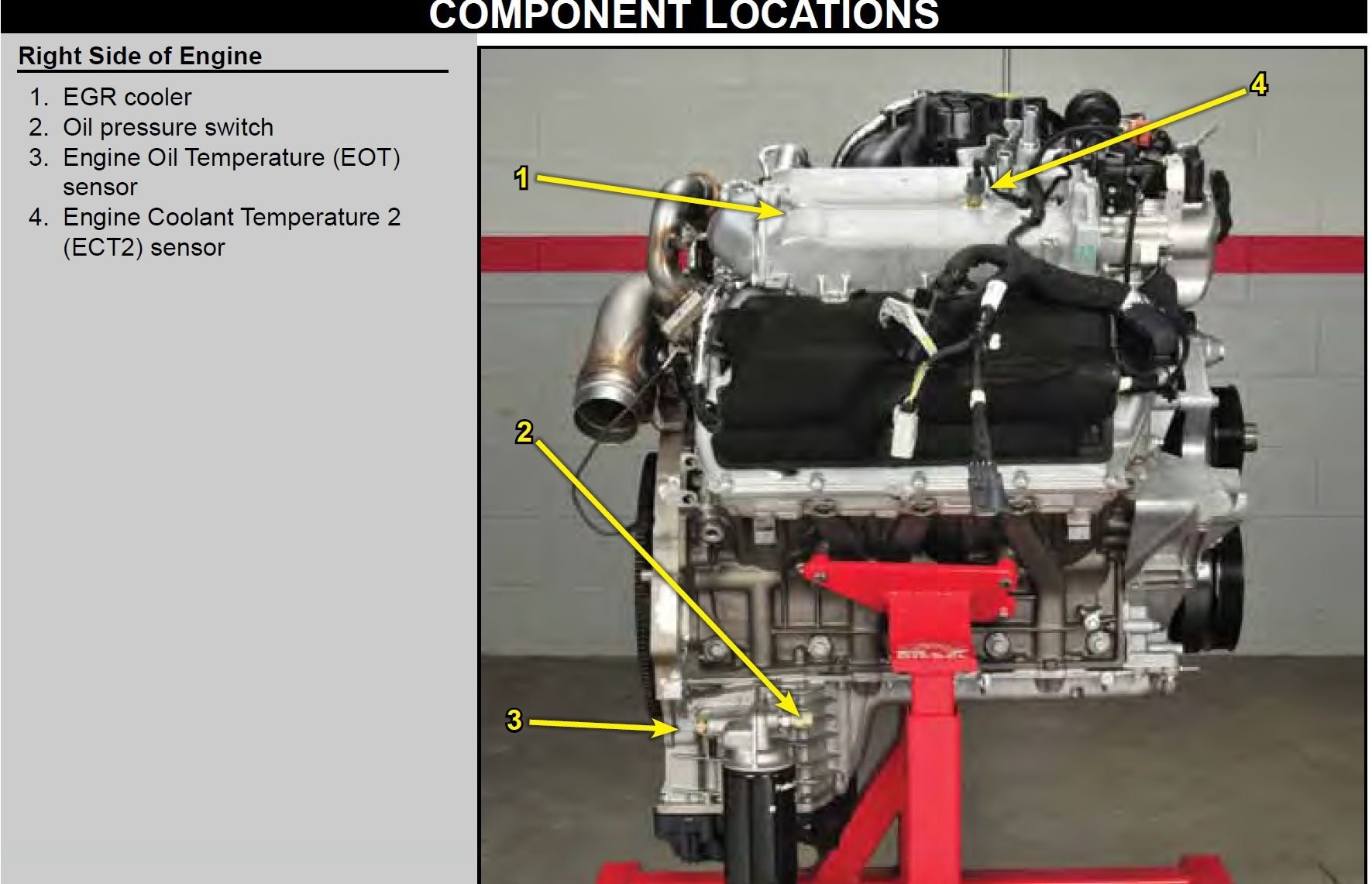

Which gauge read 37 degrees?
The engine oil temperature sensor isn't located in the engine block. It's located right next to the oil pan that doesn't see much heat from the block heater.
