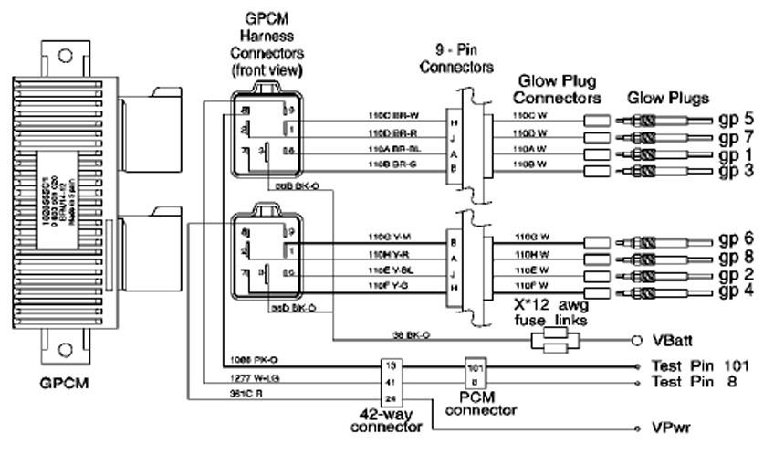

The Excursions and California Pick-Ups have a Glow Plug Control Module, When there is a P0683 code there is a fault on the PCM to GPCM circuit.
the P0676 is a fault specific to the Glow plug #6 Circuit. This circuit goes from the GPCM to the drivers side valve cover harness. I would pull the 9 pin connector off the drivers side valve cover and inspect both ends of the connector. See if you see any burnt pins. With the 1670 code - this can be related to the connector as well.
Do you have a no start condition?
Here are a couple of diagrams:
