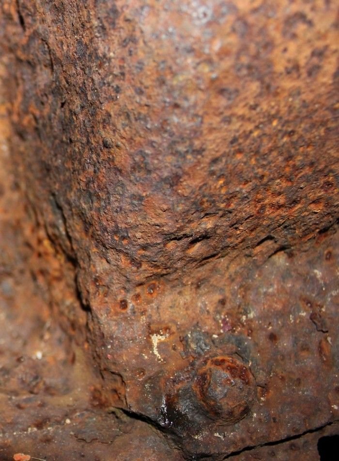

and...more important...the part of my frame where the engine is mounted is badly rotten. I would prefer to replace it, if I could get this section in good condition. The rust on my parts is so deep, I can break pieces of rust with my fingers at the edges. But only on that 2 parts and the front crossmember (which can be repaired).
These are the frame parts I mean:

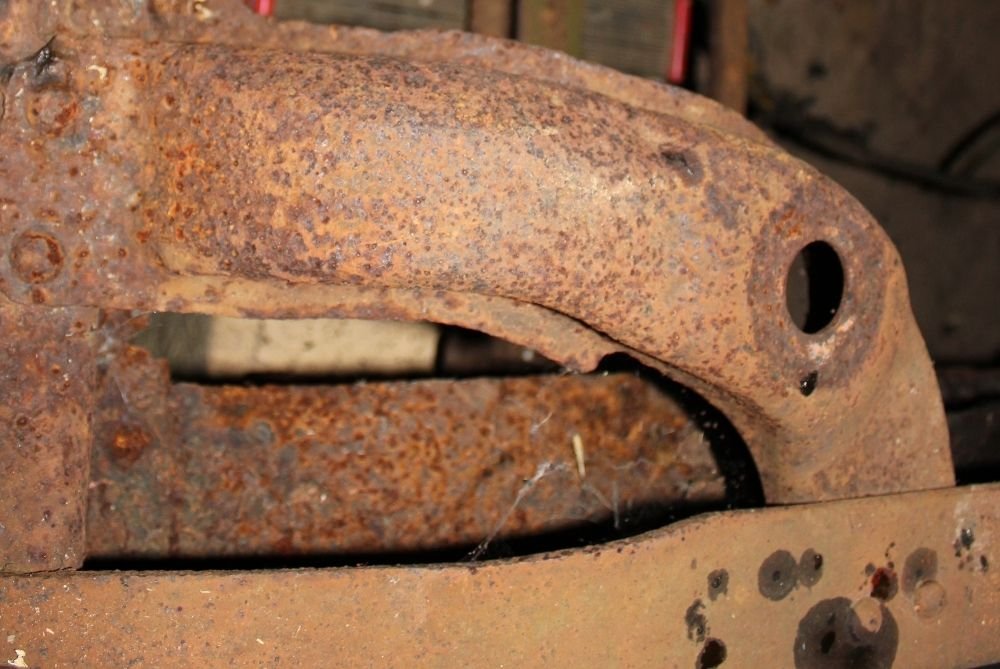

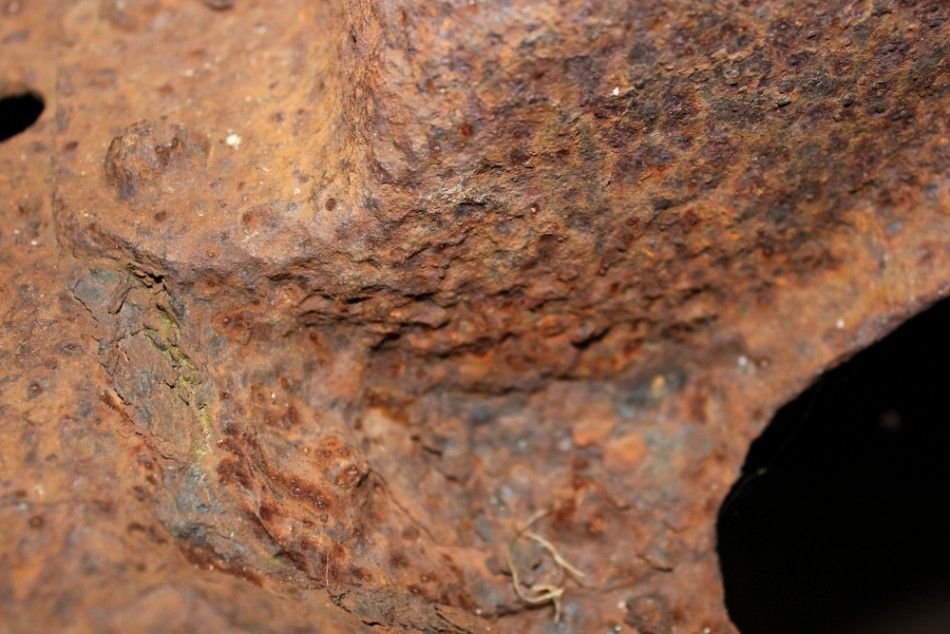

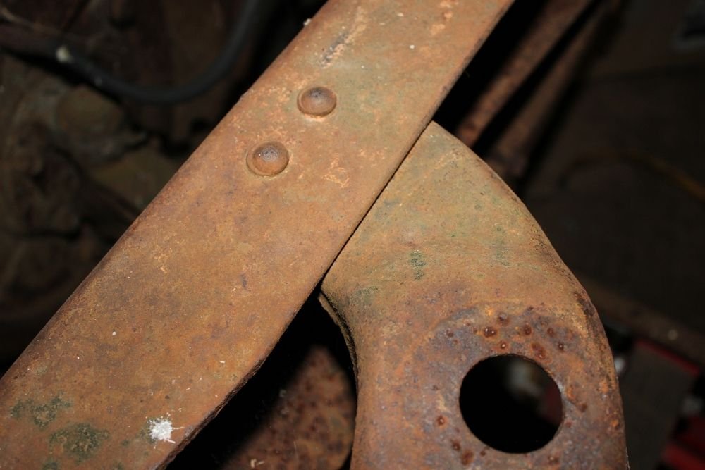

some pictures...
upper end looks good:
lower end looks...like the surface of the moon:

my guess on weight would be about 5 pounds each for the motor support brackets

Herman, I weighed pair of those motor mount brackets that I took off of my '49 F4 and they weigh 11.0 lbs on an accurate shipping scale. My brackets are marked 21T-5086 RH and 21T-5087 LH and are listed in the parts book as part of the 21T-5019A or C #1 crossmember assembly for a '42-'52 V8 truck. The brackets you need are part of the 01T-5019 #1 crossmember assembly for the '40-'41 truck. The motor mount brackets for a '42 and later truck may not fit your truck, you may need the crossmember also to make them work, or they may not work for your application at all. I can send you some photos of my brackets and or take some measurements of them if you need me to.
