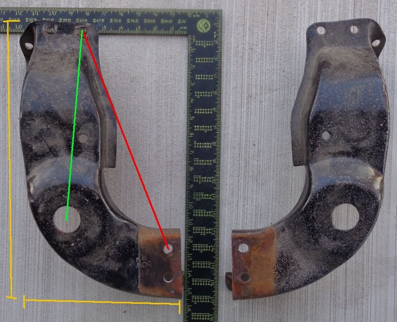

Tried my best to measure the brackets:
Length: ~ 36cm (14.17")
Width: ~ 20cm (7.87")
red line: ~31.5cm (12.40")
green line: ~25cm (9.84")
All holes in the brackets look the same. Width wasn't easy to measure, cause my brackets are still attached to the frame.
The crossmember looks different, but the mounting points for the brackets look the same.
