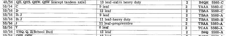

Im currently working on a 1954 ford f100.Im trying to determine if the truck is missing any leaf springs.Can someone tell me how many leaf springs there are on the front and rear?Thanks

Here is what the parts manual says.
Front has 8 unless it is heavy duty then it has 7.
Rear has....well parts book says 9.
My shop manual for 54-55 trucks says
Standard for rear is 8
optional is 9
standard for panel/optional on F100 is 7
