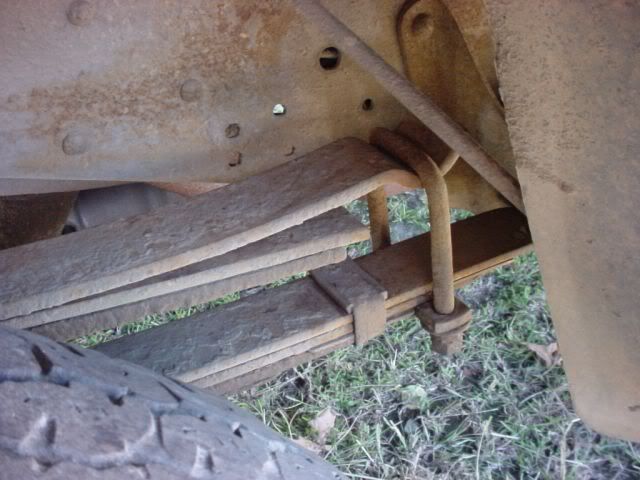

I found an '84 F150 XLT at the JY that I might be interested in purchasing for parts. Already got the instrument cluster and door switches and some other small parts/pieces, but if I get the whole truck I have some questions...
Here are the rear springs on my XL:
And here are the springs on the (possible) donor truck:
What is the difference and/or application between the two? Which ones should I have under my truck?

The ones in your truck are a heavier springs then the JY truck. BUT the JY truck has those aftermarket clamp on Helpers which are heavier than your stock one.
I personally would rather have the heaver leafs w the lighter helper(your stock set up)

To me it appears the truck has leaf spring helpers on it with the orginal springs. You can buy the spring helpers at many places.
So unless yours seem very worn id juts keep your orginal on and put in the helpers.
They will allow you too haul more in the back of your truck without it sagging as much. Also it might give it a bit of a lift too.

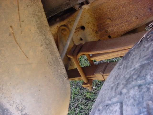

The reason I'm interested in the springs at all is this. You'll notice in the very top photo that the aux spring is VERY close to the (frame stops?) bumpers, and even when unloaded they are slapping the stops and making a hell of a racket. The other side is missing the plastic stop altogether. In the second top photo you can see the bottom leaf is cocked a little to the side, and seems to move just a little bit, depending how I bumped into the driveway.
I was told I could get a steadier ride, and fix the slapping problem by removing those plastic stops and replacing them with bolt in rubber stops (like the axle stops) 2" for the front, and 3" for the rear, providing "positive contact" to the aux spring.
But what I get here is that it might be even better to remove the light aux spring, and replace it with the helpers shown above? If I stay with the stock setup altogether like Diesel_Brad suggests, I'll still have to do something about that slapping issue...

your springs must be SHOT for the aux helper to be touching while driving w no load.

Like I said, look at the top pic, you can see how close the helper spring is to the stop. It's like that on both sides, but just the front of the spring. The second pic shows the rear of the spring, which has MUCH more clearance at the stop.
Oh Man, don't tell me my springs are shot....unless they are, but thats why I'm here, right?

YOUR SPRINGS ARE SHOT
