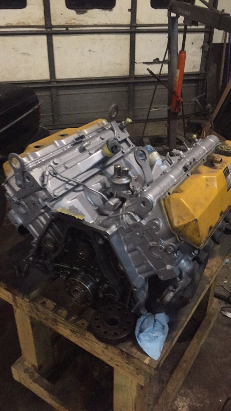

Well I've gotta major set back on it now but oh well got do what u gotta do the engine has to come out now I thought the front seal was leaking to begin with but turns out it's the oil pan seal the po didn't install it right or something I guess just another's thing I'm having to fix they screwed up wondering if u guys had any advice on pulling without pulling transmission or crossmember
Old Jul 16, 2016 | 01:50 AM
  #127
7.3 forever's Avatar
7.3 forever
Joined: Aug 2014
Posts: 1,823
Likes: 238
From: piedmont mo
Well pulled motor had it out in about 4 hours first time pulling a 7.3 but not to bad at all po definitely didn't seal oil pan or anything good so all new seals are going in and painted it cleaned with brake clean and parts cleaner and a tooth brush should be ready to put back together tomorrow or Sunday and the yellow valve covers arnt staying just a spare set I had so we didn't half to mask it off kinda like the yellow though but wouldn't go with the blue at all in the engine bay at all

Already did its black with blue wiring

The color is some silver enamel my grandpa had left from our body shop

Just an amazing sight can't wait to get it going turns out school busses have 1.00 exhaust housings it is definitely a factory turbo because of the paint
