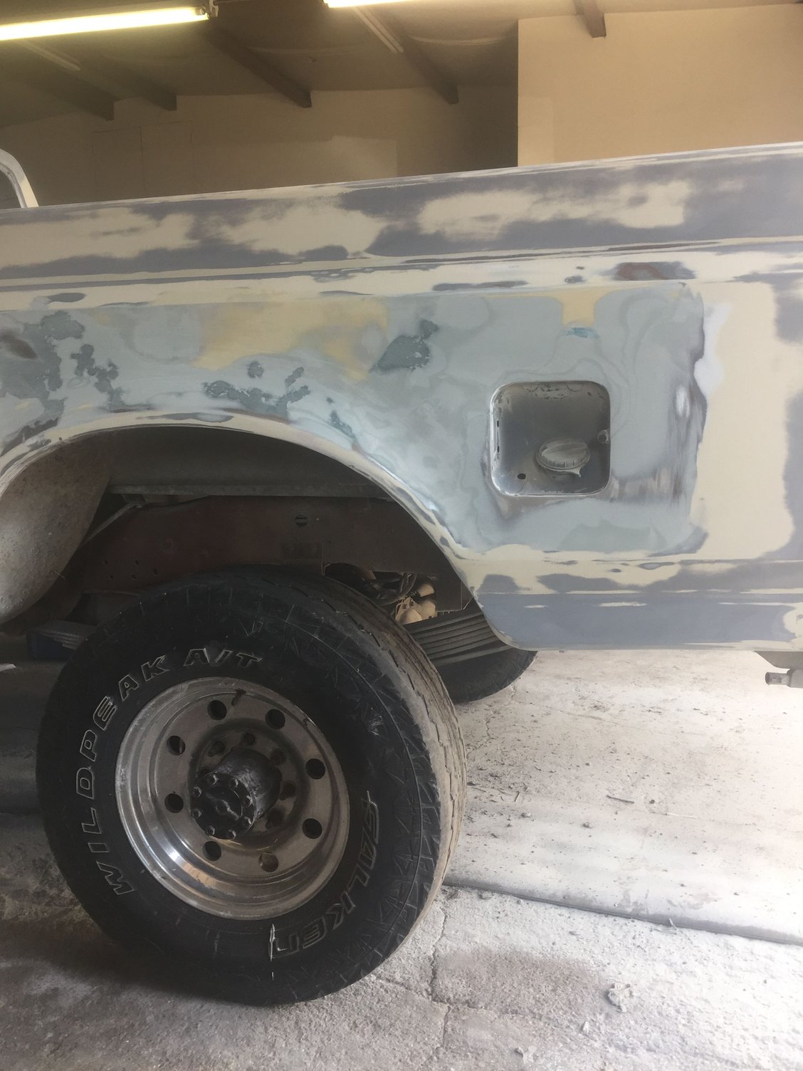

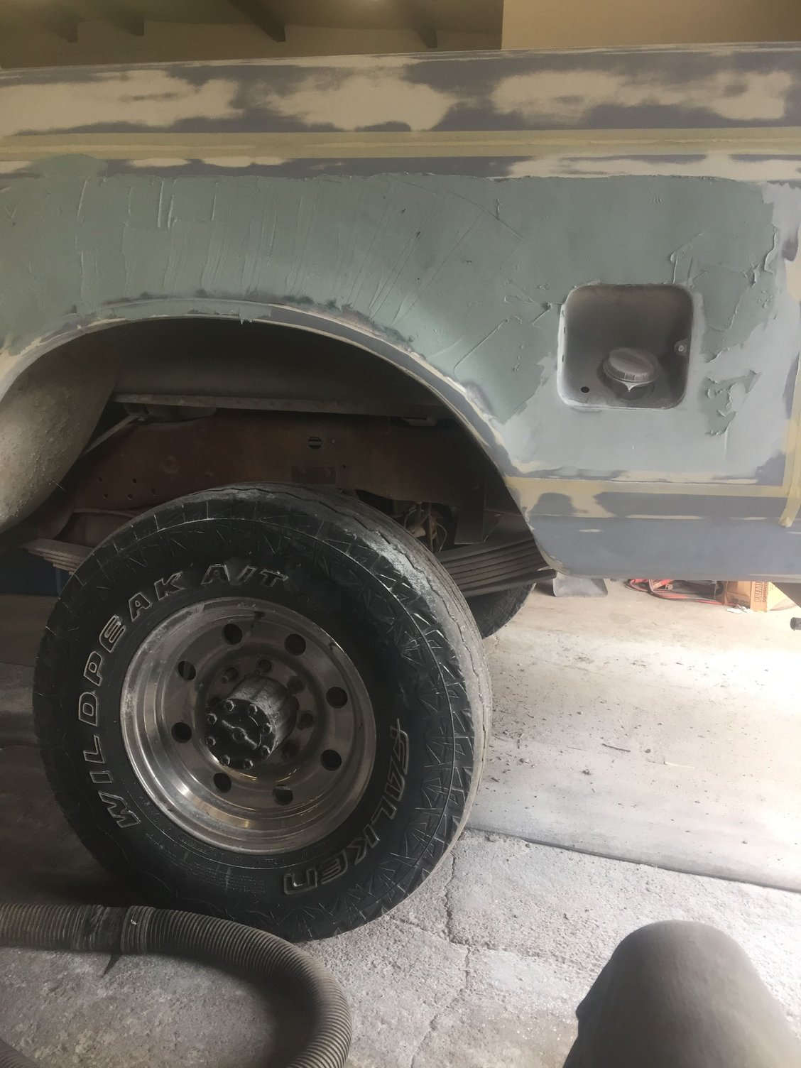

Well was about ready to pull in paint room was wiping truck down and saw some tiny cracks on driver side bedside filler cracks and I knew what it was I had forgotten to put fiberglass reinforced filler down first so I sanded it back down to metal and I'm fixing it early mistake I've done body work but never this big of a job on my own so lesson learned about fixed now though

Well here's another uptadate guys so close may not look it in the picture put it's almost perfect but have few more tiny places then I can primer it and block it out and be ready to go

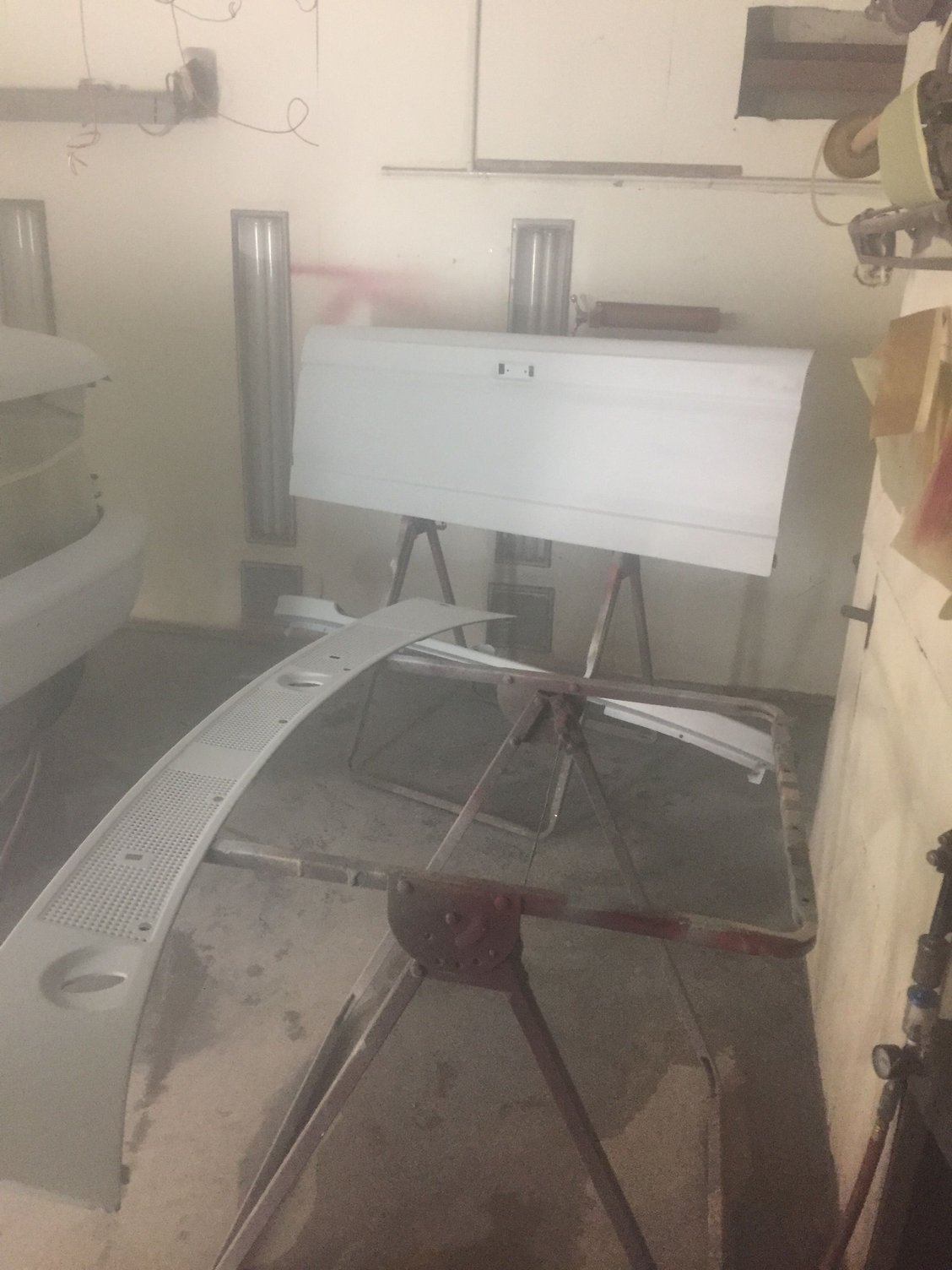

Well got bedside primered and valance panel primered

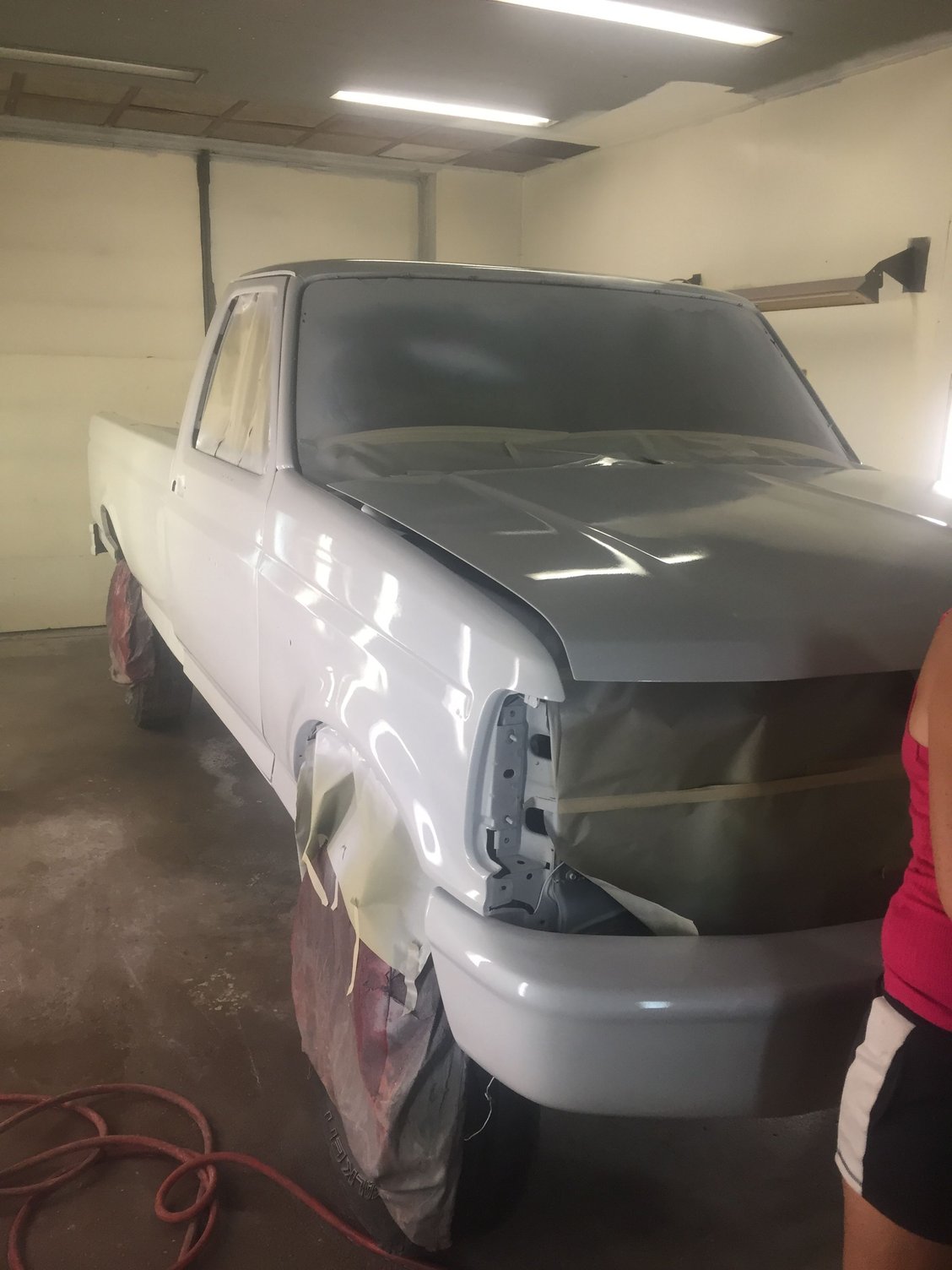

First coat of paint is on it two more and 3 coats of clear and it's good to go

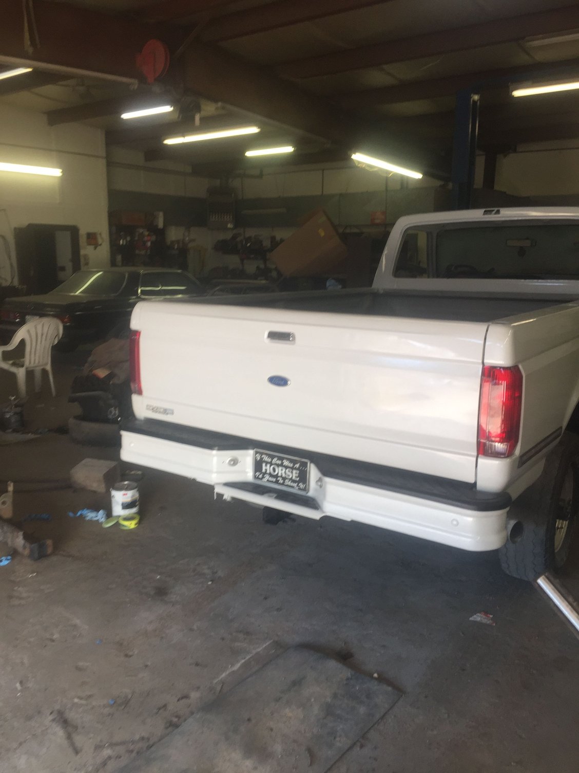

That was about 4 hour after last coat of clear I'll get couple more pics of it outside tomorrow

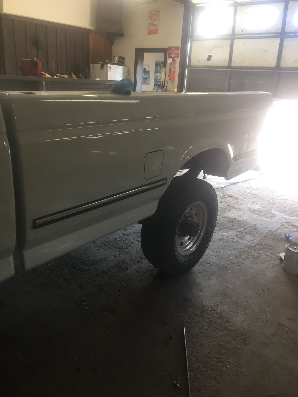

Well getting there slowly but surly

Theres some imperfections but Itll polish up good but this is probably my last paint excursion not my line of work love working on these trucks just not body work
