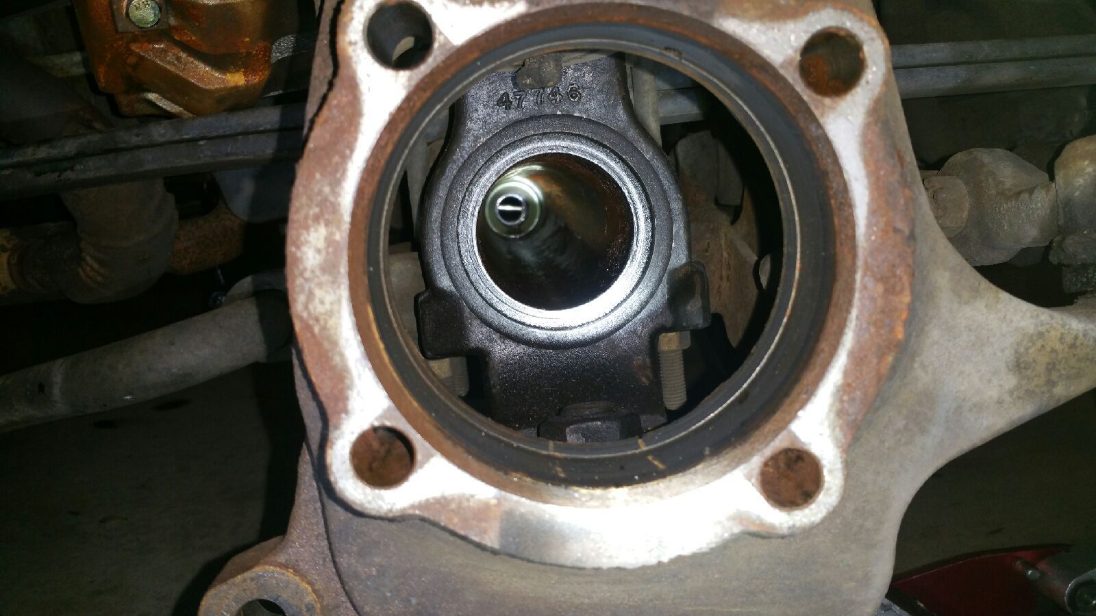

Hey all, I have a 2002 Ex XLT V10, just started the front end upgrades etc..
The Axel needed seals, but there is one in particular I can't get right, does anyone know which part number goes into this area??
This is where the Axel & Diff meet, inside of that Axel shaft.
I need a part number and a picture of the seal, I have tried so many, I think I will end up taking it to FORD.

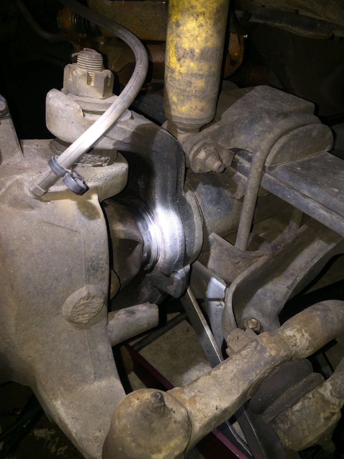

The smaller hole needs a Seal, that is a picture of the Axel Shaft.
This is a look of the part Ford sold me, and it still allows a leak.

I don't have a part number for you (but will look), your second pic highlights the outer dust seal (only keeps dirt and muck from getting onside the axle housing tube) the actual inner axle seal that contains the oil to inside the differential is located at the diff. To replace them the carrier needs to be pulled then the seals get pressed in via the open diff case.

Doc, I updated my other post with a link I found that has the seals and the installation kit. The seals you need are the inner axle oil seals.

Thank you, I received a part number from Ford, 3T695. that and the dust seal. I hope this is done an over with.
