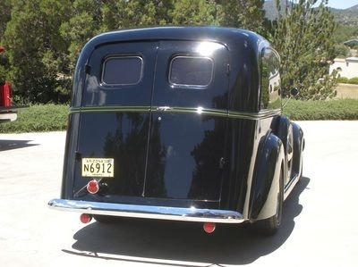

The rear panel looks 80% better than before. It sounds like you are going to eliminate the flat bar additions to the bumper brackets. ++
The Pontiac tail lights would look great on the rear panel but you may have to patch in those holes at least partially before installing the round lights.
I like original tail lights but finding two of them might be a problem. Originally they probably only had one tail light?

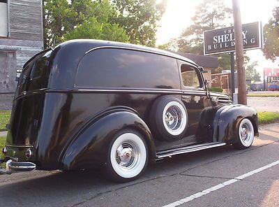

It looks like you have more room above the bumper, like this one.
Sorry, the whitewalls kind of burn my eyes too.

I think they only had one and probably was mounted to the license plate which hung from the left door. It's going to be a daily driver (hopefully) so I want turn signals.
Also I like these but I don't want to make it look like a chevy.
39 Chevy Chevrolet Primer Taillights PR Talelights Rat Rod Hot Fink Traditional | eBay
or something like these
Ford Model A Hot Rat Street Rod Custom Car Truck Stop Lens Black Tail Lights | eBay

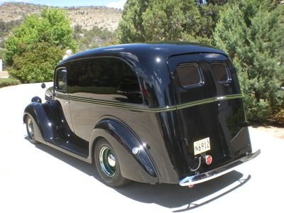

Mine I think is original with the one light and bracket. I did add another because I like good, visible brake lights. I guess it doesn't show in this pic my wife took when I was rebuilding my rear leafs. It's on a boly on bracket on the rifgt bumper support. Easily removed by a future 'correct restoration guy'....
