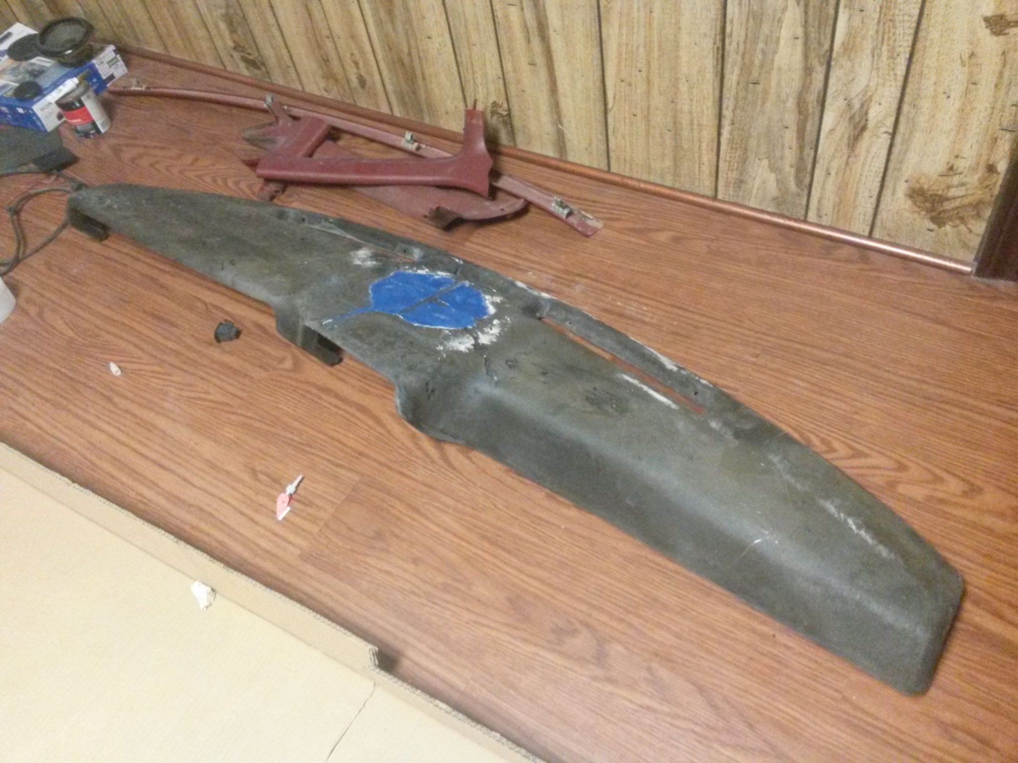

I'll have to post once I get it done. But I just finished peeling the old cracked vinyl off of mine. Fiberglassed the center speak grill over. Now just to get some new fabric, about $40 and some adhesive - good as new.

Are you sure it's plastic? Mine (1980) is a foam core wrapped in vinyl, so old and brittle it feels like plastic and cracks like it too. You can pick up two way stretch vinyl at a fabric store relatively cheap and the color options are crazy. Just lay it out, cut the rough shape, spray the adhesive as you go, wrap edges under and staple.
As far as dealing with the cracks, after the old vinyl is peeled off you just bevel out the original foam with a knife, fill the beveled out crack with spray foam in a can and shave it down with a knife or similar.

This is what you'll find under the original vinyl. Use a heat gun/blow dryer to soften it up and it peels right off.

Oh ok, I misunderstood. Could probably fiberglass from the back side and have it last forever but you'd probably still see the cracks.. unless you wrap the plastic in vinyl too? Or possible some high build primer and then top coat.
