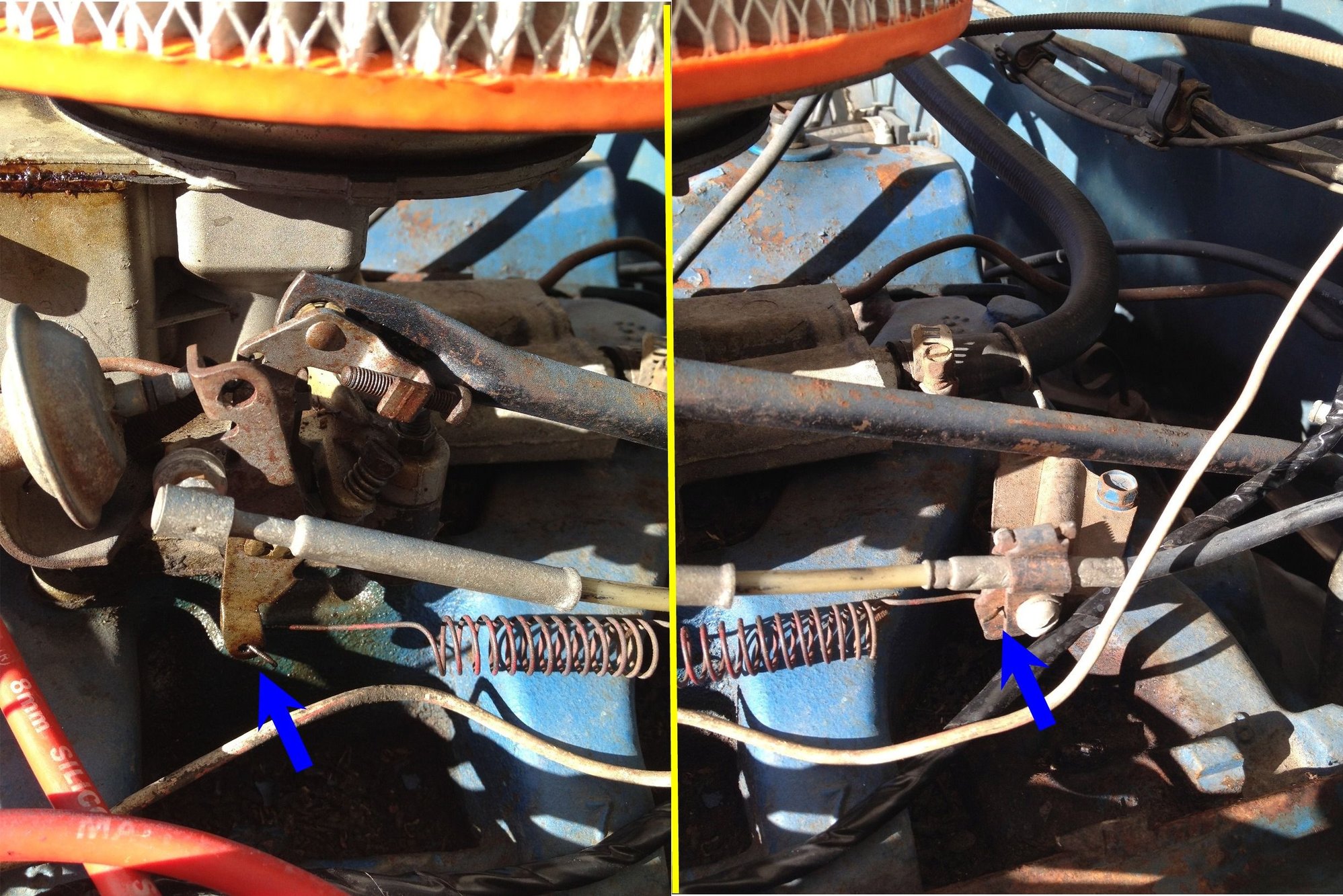

Can anyone please provide some pictures of the throttle return spring on the carb and how its attatched. Mine broke off and i never payed attention to it till now. Thanks.

Pictures
The adjustment screw fell out too

Autolite 2v hookup ...

By the way that ground on the bracket actually belongs back under the last intake manifold bolt/spacer on the same side.
