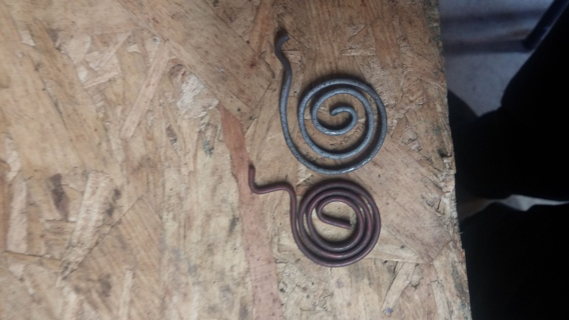

Just got my kit.. Don't think its gonna work

Your original looks homemade, Johnny. Is that new spring from the "kit" sold in the eBay auction?

yes it's the new spring from the ebay kit. I don't know about homemade..i thought the old spring was just sprung, but anything is possible with these old trucks. is there a lot of tension on these springs when they are working right?

i just got done putzing around with it, seem like it would take a lot of force to get my spring to sit right. so i'm thinking this new spring is just not going to work.

The "leg" that would bear on the latch on the red springs doesn't stick out far enough to hit the latch surface, even if by some miracle you could wind it on there.

I just ordered some door lock latch springs and the remote latch springs from another Ebay vendor. I contacted him about the 48-52 springs being wrong. He found the 38-47 springs and they look like the correct ones Ross found.
I'll let you know when I get them. The vendor is whiterivertreasure. His store is Joe's Auto Door Lock Springs. Kind of pricey but he has a lot of springs for vintage vehicles.

I got both sets of springs today. They are both correct and I got my driver side latch together.
I bought the 38-47 door lock latch springs and the 48-52 remote latch springs. Both fit perfect.
