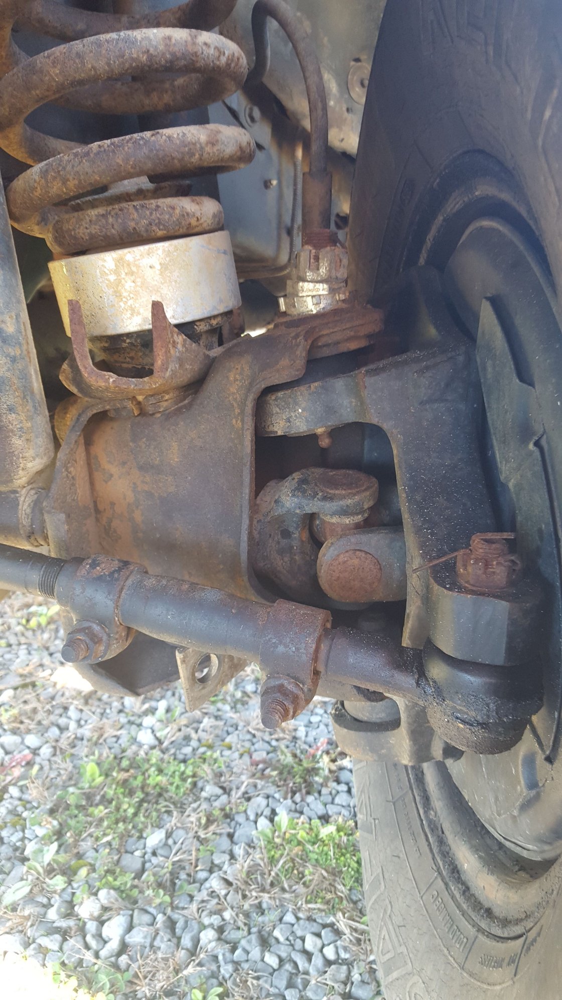

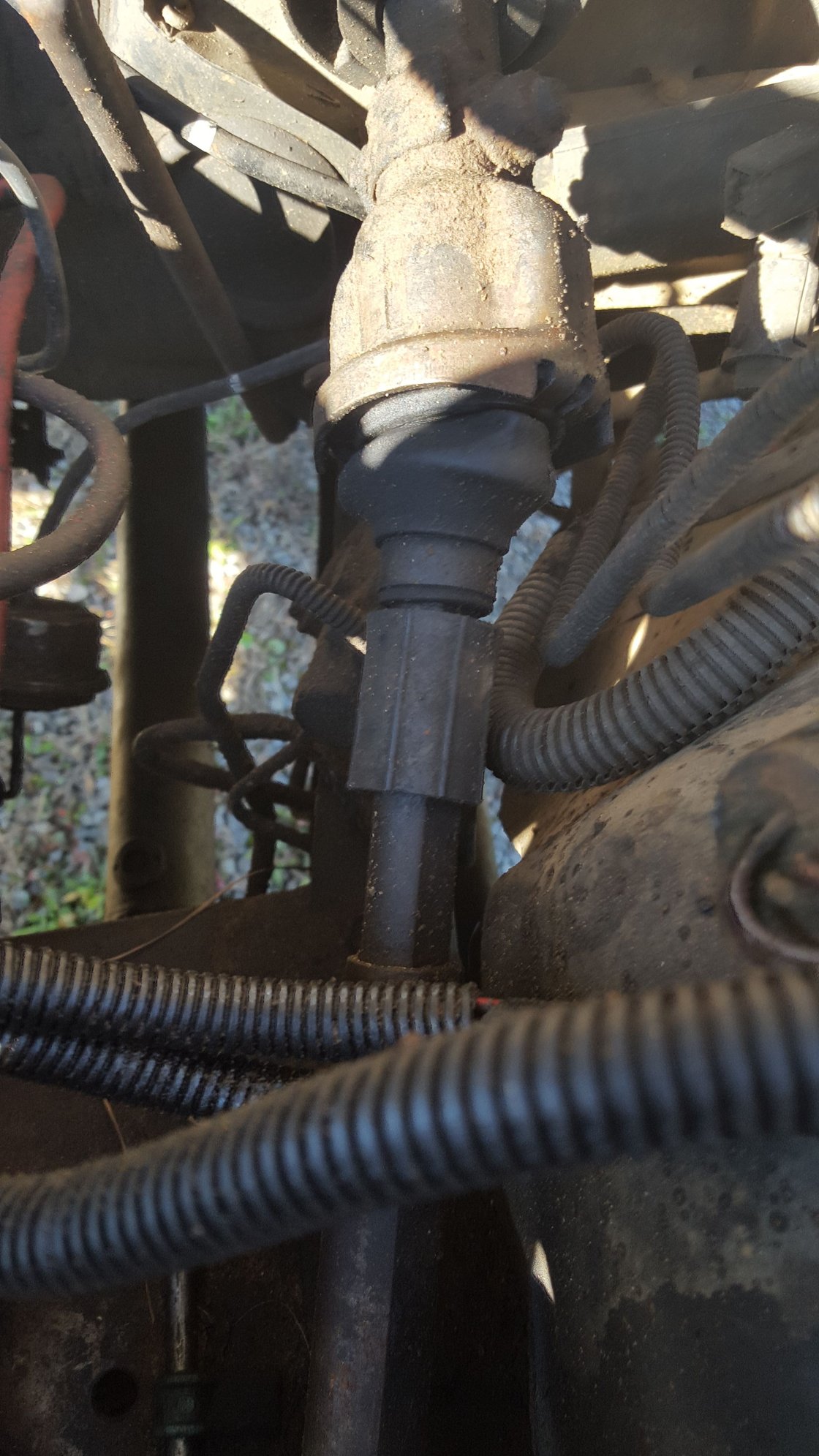

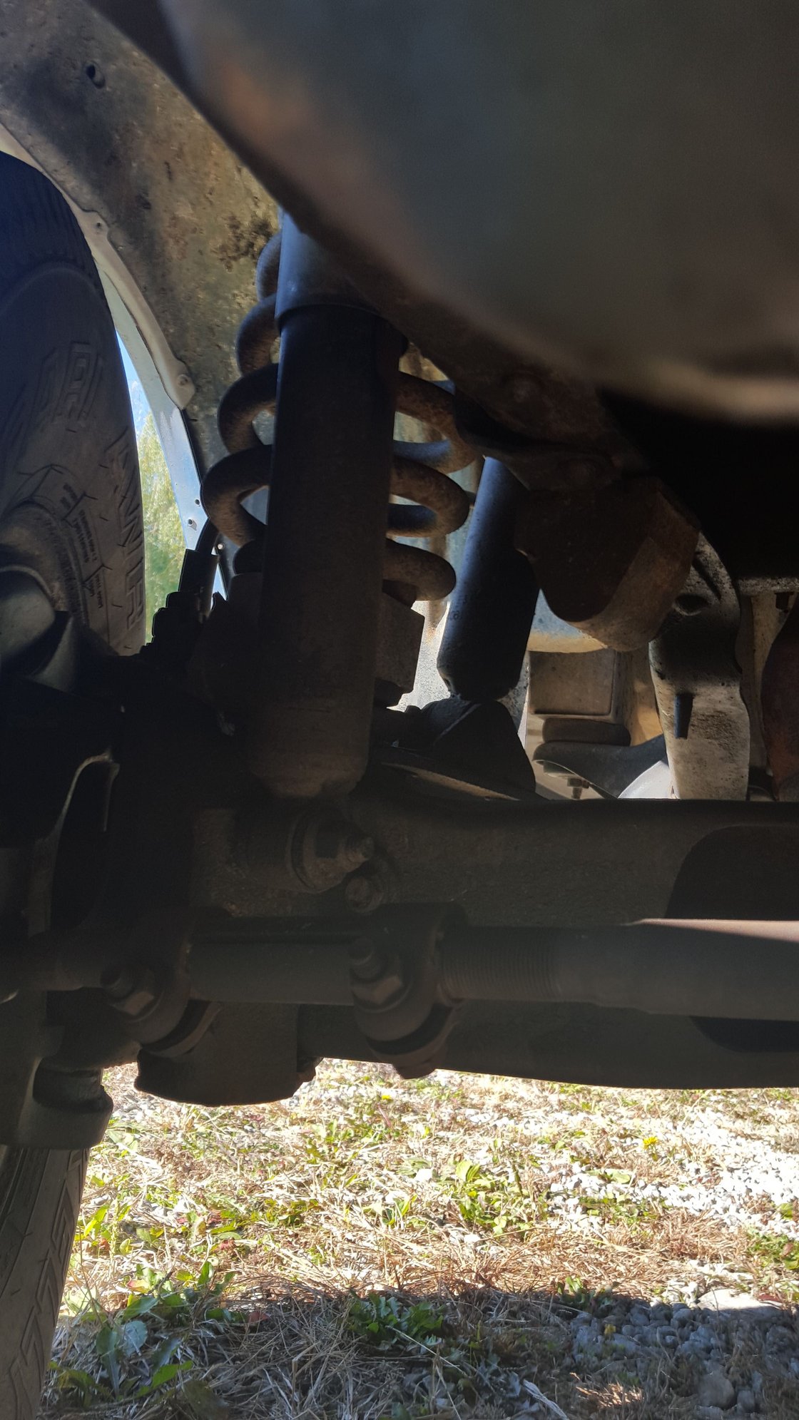

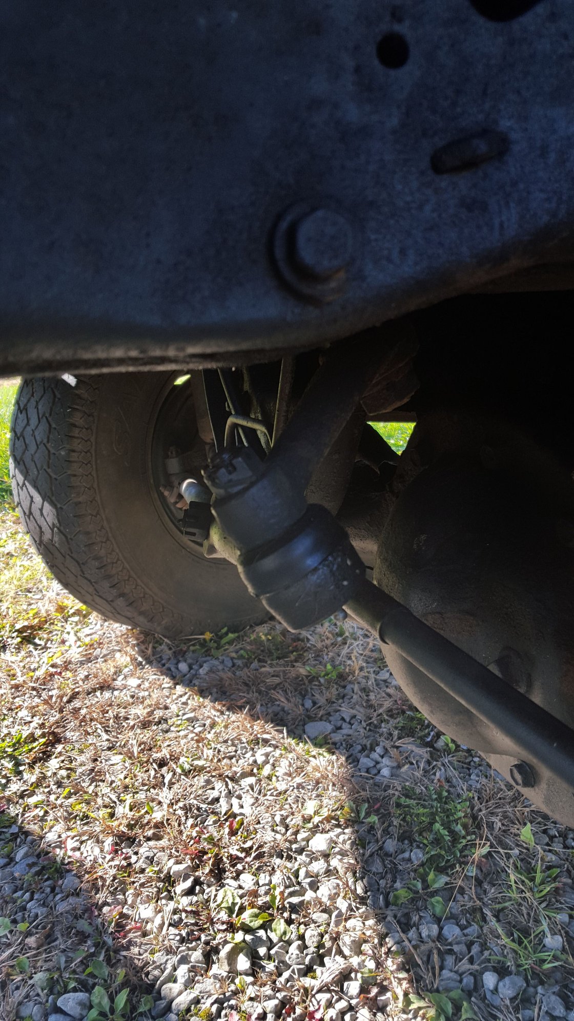

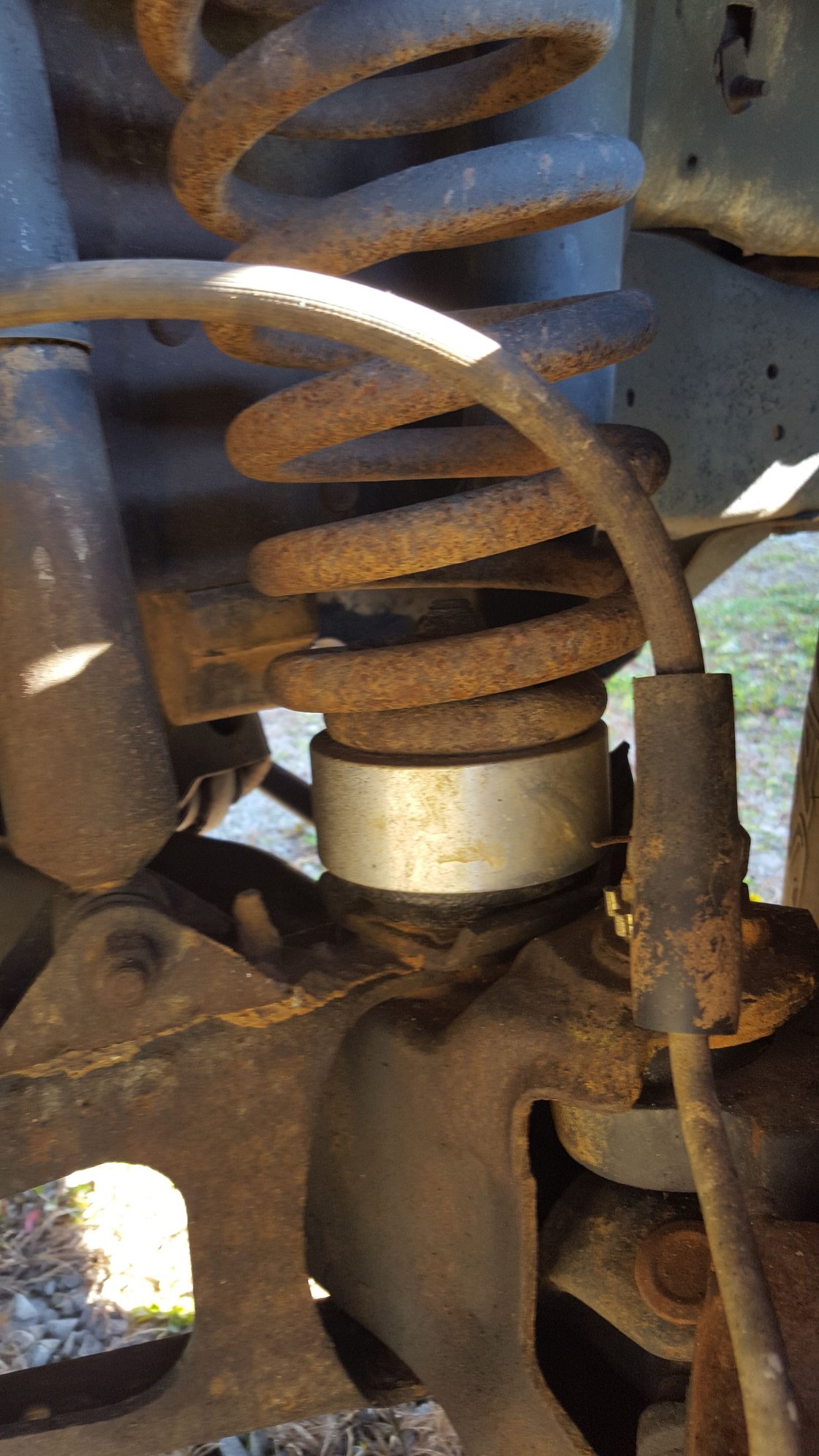

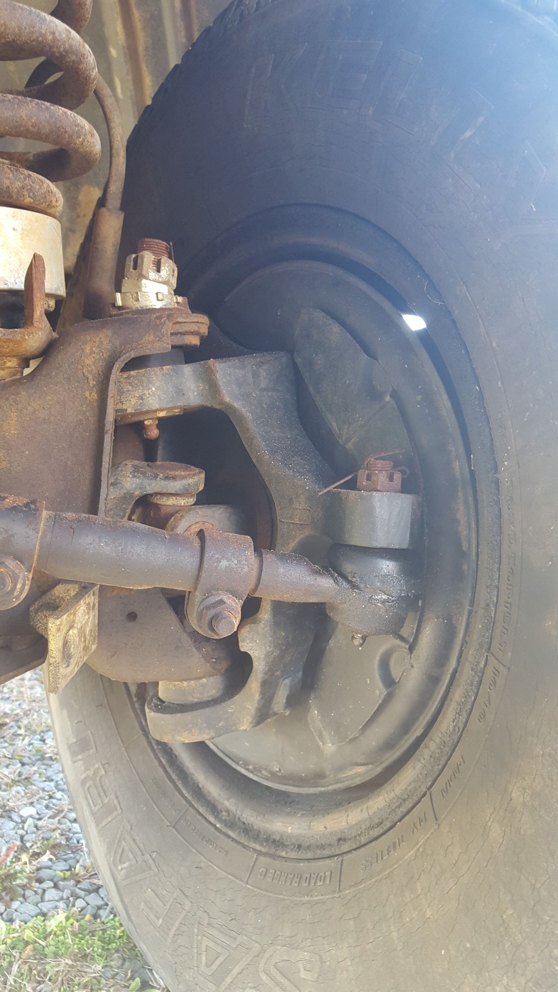

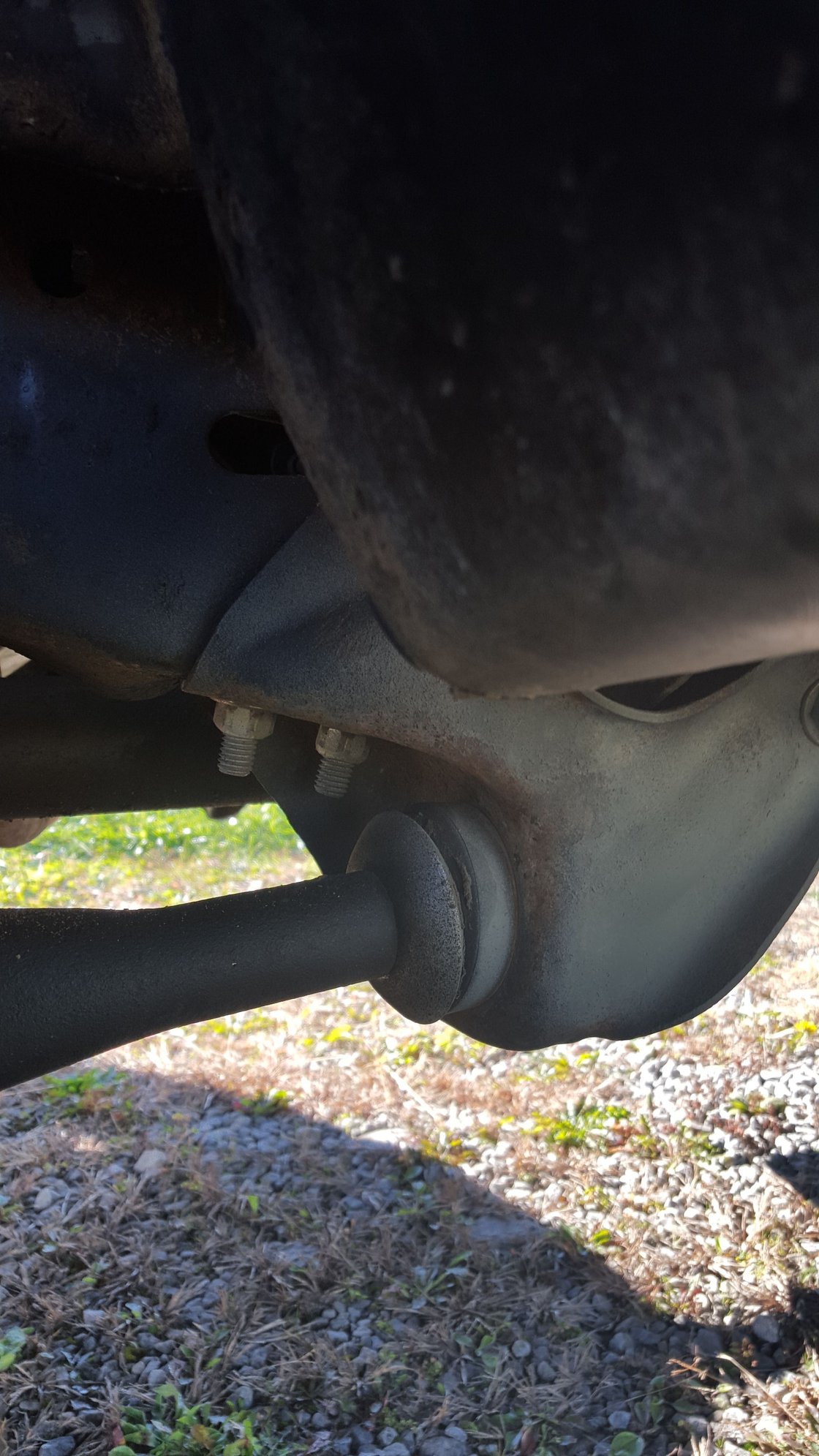

Well it looks like the frame, pitman arm, drag link, tie rod ends and radius arm bushings are all good but the steering gear might just be worn out. I think the PO was stabbing at the steering problem by throwing parts at it. I am not really comfortable adjusting the gear given everything i have read on FTE about tearing up the gearbox with limited or no steering return. I'm pretty sure this truck has 256,000 + miles on it. (South Carolina doesn't register mileage on a new title transfer after 10 years). The intermediate shaft has some rotational scoring near the gear which concerns me. I guess I'm looking for FTE to kick me in the butt and say just bite the bullet ! lol And look at the killer dry rot on those tires! sheesh.
Driver side looks to be incorrectly installed
Passenger side looks installed correct
Looks to be a 3" lift in the saddles

Take those lift spacers out. I bet they can't get it in alignment with those in place. If they just stuck those in there that's probably half the the problem you are having.
If you want to check the steering box, get someone to lightly wiggle the steering wheel back and forth and check for play in those spots you photographed.

The 4th pic down the upper ball joint doesn't look right to me.

I'm thinking that both of You are right....the spring spacers threw the geometry of the steering/suspension off, causing the PO to "shim" the upper ball joints in a failed attempt at trying to bring it back in line. I was in the middle of trying to PhotoShop that (4th) pic to ask: "is this normal?"....I didn't think so. So now, the spacers will be removed and I will replace the upper ball joints, or at least try to salvage them. This may be better suited for a new thread but, I want to put a 6' snow plow on the Ox after all of this is straightened out. Should I move towards F250 springs? (without the crap spacers of course).
