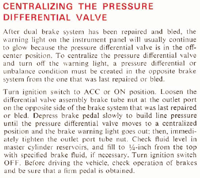

Most likely, the pressure differential valve spool has shifted (this would be confirmed by the Brake Warning light being lit up on the dash).
You probably still have air in the brake system but, you'll need to recenter the valve spool before continuing to bleed the brakes out.

Bleed the entire system.
DOT 3, 4 and 5.1 brake fluid is only good for 18-24 months before it needs to be changed. Old brake fluid gets saturated with moisture which degrades stopping ability and it corrodes brake components, causes them to fail and causes the brake valve to get gummed up and stick.
