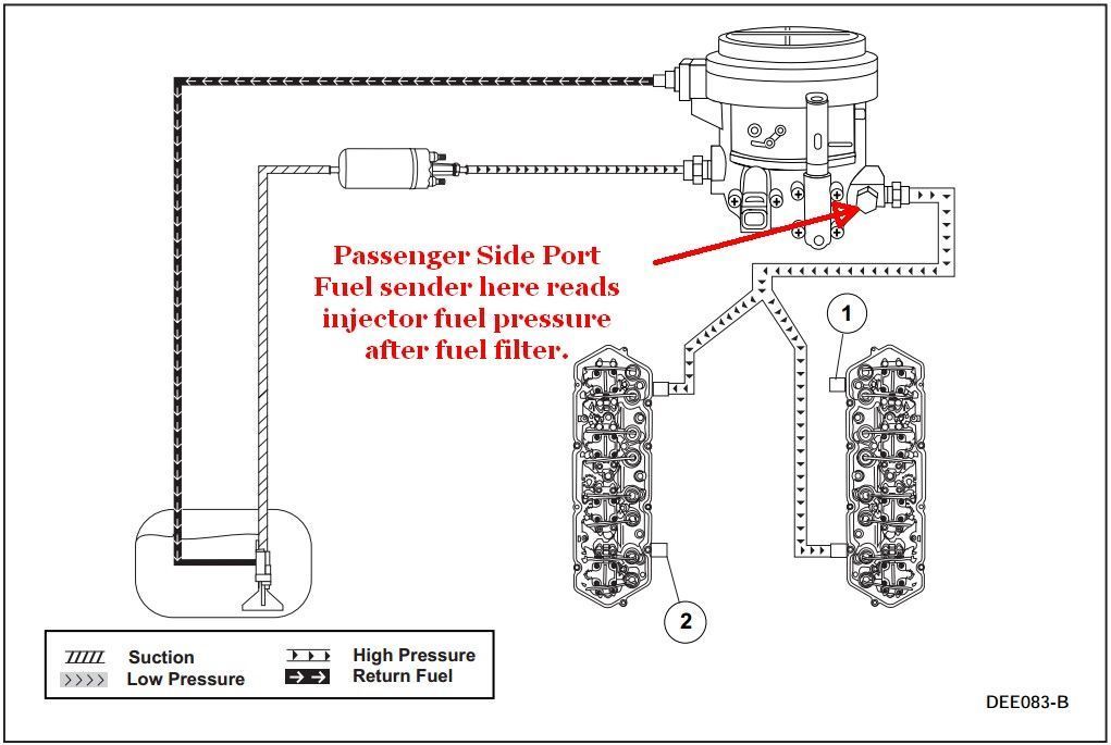

There are literally several things that can cause such a complaint.
First, let's rule out the most obvious, Fuel Pressure.
Fuel Pressure Testing:
Tools: Fuel Port Adaptor (M12 1.5) and Pressure Gauge 0-160 PSIG / DVOM
**The Mixing Chamber Screen should be checked. Which, can be a pain. Someone, somewhere, "missed the boat" on this design. There is no "magic" formula to identify this type of obstruction. Forcing Fuel using Air to dislodge the contaminates can often identify the issue. **
** Fuel Bowl Test Port Spec. 45 psig min See 8c. below
8b. Right Head:
a. Fuel Pressure at the right head Verify that fuel is in the tank and the pump is being powered.
b. Measure fuel pressure at the front of right cylinder head Road Test- engine at full load condition Spec. Measurement / Head 0-160 PSI / WOT 45 PSIG min.
c. If fuel pressure fails low, go to step 8c.
*If pressure is above min. spec, go to step 8b. and repeat procedure on Left Head (Left Rear). If fuel pressure fails low, go to step 8c.
d. Fuel Pressure at the left head Measure fuel pressure at the front of right cylinder head Road Test- engine at full load condition Spec.
Measurement / Head 0-160 PSI / WOT #42 PSIG min. (45 because you can't find #42 on any gauge I got). Another line on the FoMoCo Manual that should have been proof read.
CAUTION: Secure hose away from turbo and exhaust if fuel pressure is below min. spec, replace left check valve if fuel pressure is above
Min. spec, * Go to step 9.
8c. Electric Fuel Pump
a. Measure Fuel at Fuel Bowl Test Port using Fuel Port Adaptor (M12 1.5) and Pressure Gauge 0-160 PSIG / DVOM Spec: 45 psig WOT (>42 psig)
b. Measure at fuel outlet from electric fuel pump: Engines built since 1/1/98 or engine serial #661496 should be 51 ± 4.5 PSI @ idle.
c. Road Test- engine at full load condition 42 PSIG MINIMUM*
d. If fuel pressure fails low, go to step 8d.
e. If pressure is above min. spec, replace right check valve.
8d. Electric Fuel Pump Inlet Restriction
a. If fuel line is restricted above 6 Hg, check for: blockage between pump and fuel tank.
b. If fuel line is not restricted, inspect regulator valve condition and for debris, If OK replace pump.
*Testing Procedures on all 7.3 DIT 1999.5-2003 F-250-F-550 Models*
