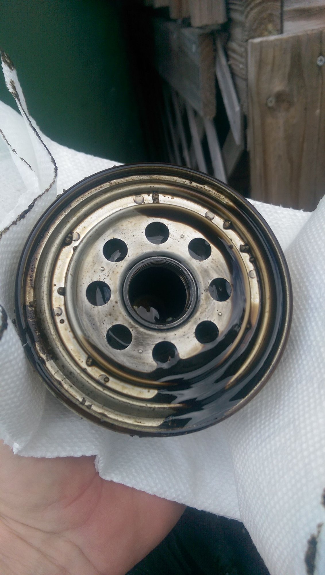

I purchased a new to me 1999 Lariat F250 SC LB 5.4L with 98,848 miles. The previous owner had been taking the truck to Jiffy Lube for his oil changes. I climb under the truck and find yellow sealant around the drain plug. I think this can't be a good sign. I scrape the sealant off and put my wrench on the plug and it would not budge with one hand on the wrench. So I put both hands on the wrench and it still will not move. Now, I am not a small person, 6 foot and 230 lbs. I have also been a turning wrenches for a living for over thirty years. I had to put some serious @#! behind it! with both hands!! I am able to get the drain plug out and replaced it with a quick oil drain. I move on to the filter and sure enough it would not budge. I had to drive a screwdriver thru the filter to loosen it. The filter was so tight the o ring remained on the engine.
The moral of this story is DO NOT GO TO JIFFY LUBE!!! Avoid them like the plague!!!!
My new oil filter wrench
The result of using the new oil filter wrench
Filter was so tight the O ring stayed on the engine

Yeah, one of the things I loathe is doing the first oil change on a used car purchase. Drain plug, insane. Oil filter...nuts. I've had them where the screwdriver would basically tear the housing.
As for the o-ring. Learned that lesson a couple years ago. Put the new filter on and started the car. It proceeded to start emptying the crankcase at 40PSI onto the driveway.
Always check for the o-ring.

What's so stupid, pretty much any oil filter has the spec printed right on the side. Doh!
Seated plus 3/4 turn by hand. That's plenty tight, they don't leak, they don't fall off, plus, can be removed by hand as well.
At a guess their policy of reefing everything down to 40 yd/tons is simply because now and then somebody will forget the oil pan bolt altogether. Oops. Overtightening has been a problem for decades. So what happens is, one person $h*ts their pants and then everybody's gotta wear diapers.

I learned 60 years ago working in a gas station that NOT putting oil on the filter gasket will cause the condition you described with the oil filter. I hate letting nyone changing my oil. I bought tires from Walmart ONE TIME. They installed the valve stems with pliers or vise grips. That was why only ONE TIME.
