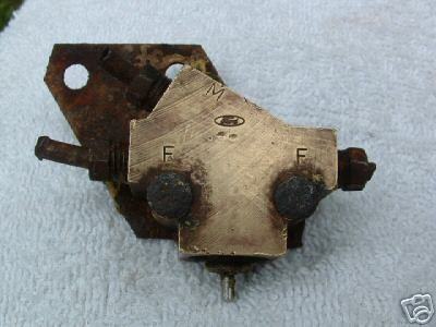

Hello,
I have 1973 F350 Super camper special. After installing new master cylinder, rotors, calibers, pads, brake hoses, the front brakes lock up after they are bleed. Could this be caused by the disc brake proportioning valve? (see attached) Where do you get a replacement? I have never seen both calibers lock up. Only seen one which is usually caused by a bad break hose.

^ C8TZ-2B161-A .. Brake Pressure Metering Valve ^ (see 2B161 at center left in parts catalog pic) / Obsolete
1968/72 F250 2WD & F350 with optional dual piston caliper disc brakes / 1973/79 F250 2WD with single & dual piston caliper disc brakes / 1973/79 F350.
C8TZ-2B257-G .. Brake Pressure Differential Valve (see 2B257 at far right center in pic) / Obsolete
1968/72 F250 2WD & F350 with optional dual piston caliper disc brakes / 1973 F250 2WD & F350 with dual piston caliper disc brakes.

Adjusting Booster Output Rod Length
I'm guessing that you have a power brake booster (?). If it and/or the MC were recently changed, the output rod between the booster and the MC may be adjusted too far out.
If so, this would keep the brakes partially applied at all times, even when you aren't pressing down on the brake pedal. It will also make it very difficult to get all the air out of the system, since the pistons inside the MC will not be able to fully retract even after you take your foot off the brake pedal.
There should be between .005"-.010" clearance (freeplay) between the tip of the booster output rod to the MC.
How to adjust the booster output rod to the MC.
http://www.maximummotorsports.com/as.../MMBAK-1r1.pdf
