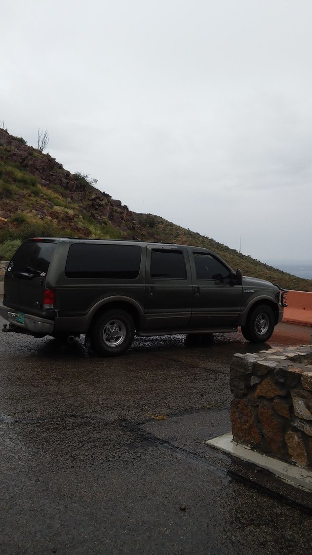

According to the tire places the biggest you can go with the stock wkeels are 285-75r16
Heres how they look on but mines 2wd
