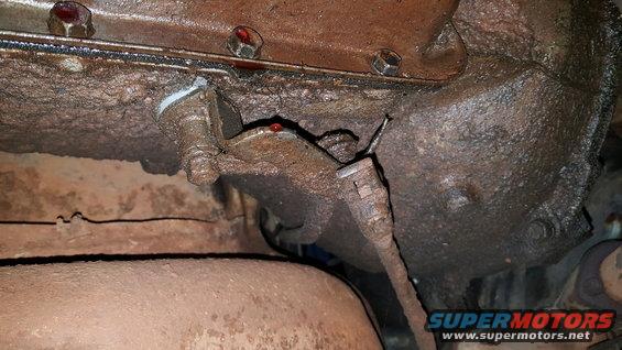

Here's a pic of my C6 from a 77 f150 351m. The shift lever when pushed all the way to the rear puts the trany in park. It seems like you could point your lever up, push it to the rear, disconnect your linkage put the shift lever in park then adjust and reconnect the linkage. That's the way I did mine and it shifts great. Good luck with it.

Sorry about the pic being upside down, it's in park.
