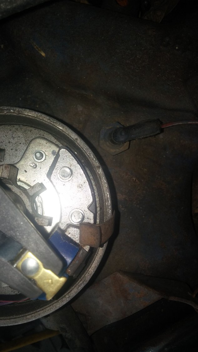

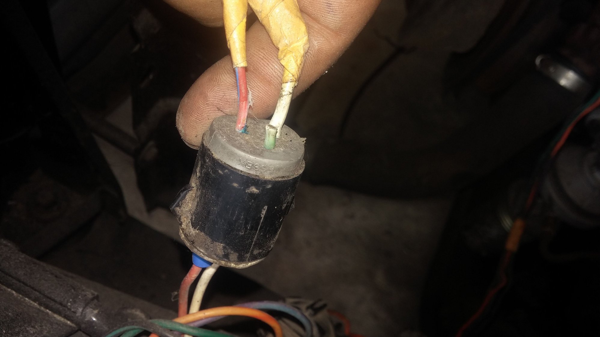

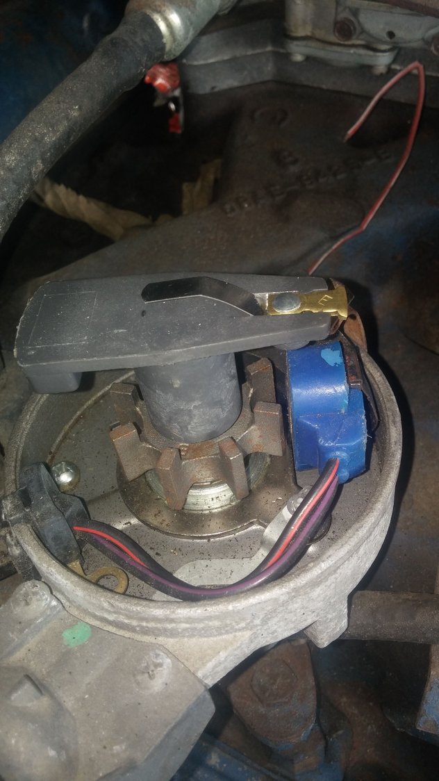

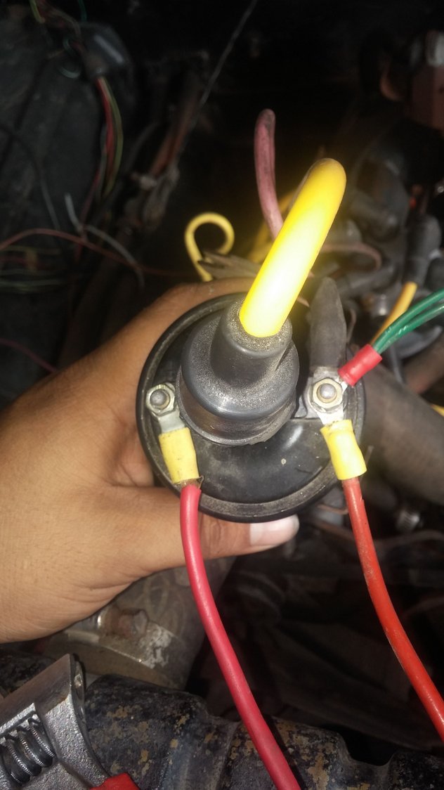

IBelieve im not dealing with points.?
This thing is a frankenstein. All i believe all wires r cut on d firewall. I can re wire but i need diagrams
Can anybody help me out. Im not familiar with these era ignition components. Need to know what ignition system i am working with.
Ho do i wire the coil to the box then to the dizzy?
What is this box and what are those wire for
Those 2 green wires on the right are going into the ignitor bo?)
This is coming out of distributor. Duraspark?

That left red coil wire is one **** poor crimp job plus ez to short to ground and cook something.
All the how to wire these Durasparks up is all on the net just use google and the would opens up to info your seeking.
