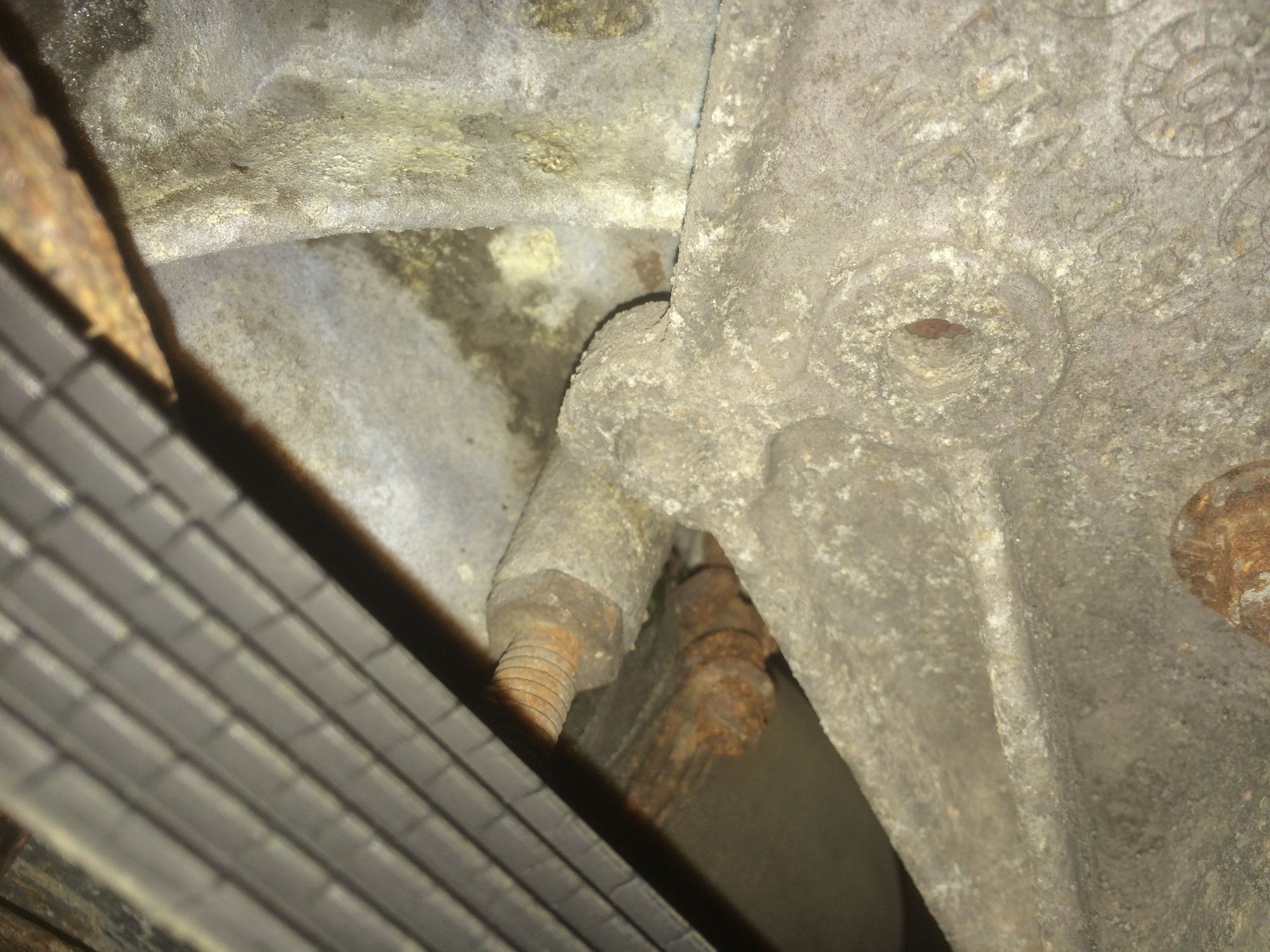

this is the power steering bracket. i was told that if it was a 351 the bracket wouldnt be that close to the water pump.

As far as I've been able to tell, this is the easiest ID between a short deck SBF Windsor (303/5.0) & tall deck SBF Windsor (351/5.8)
The 351/5.8 has this diagonal casting at the distributor & the 302/5.0 does not. You don't even have to see it. You can feel it (or its lack thereof) in the dark:
